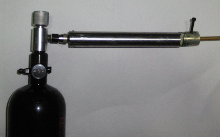

This was originally intended to be a single shot high velocity gun, but thanks to POLAND_SPUD for the thought :P ;) pour some BBs into the chamber et voila, full auto!
Nothing much to look at, basically the setup is as follows:
paintball tank->ASA adapter->BB chamber->detent seal->barrel
The barrel is 36 inches long and I'm running it at 800 psi, look at it go:

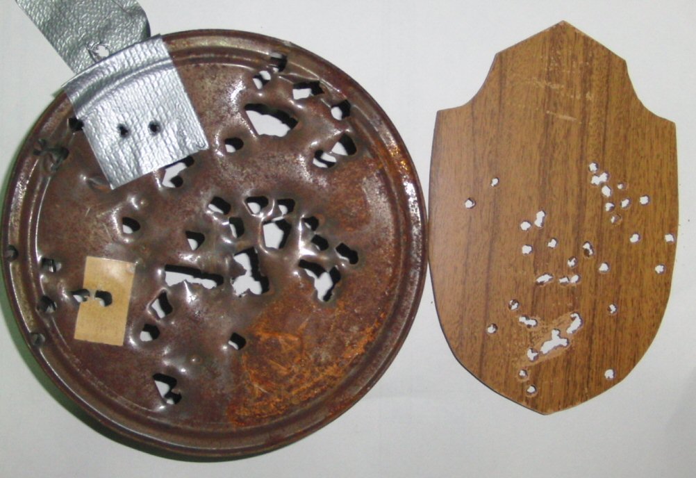

Very reliable, fires every time unlike some other attempts, I suspect this is more to do than the low weight:volume ratio of the projectiles than anything else. Also if you look at the targets, some dents on the biscuit tin suggest some rounds had less power than others, which is an indication of either double feeding or one round blocking the breech before the preceeding round has left the barrel.
biscuit tin and 1/4" fibre board targets
the firing setup, crooked but pretty is as pretty does ;)

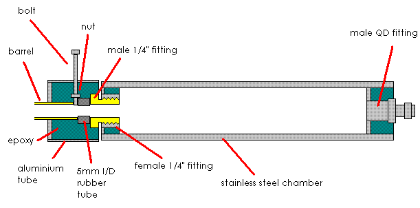

could you add a cutaway view of the launcher?
Here you go, nothing spectacular:

oh damn it's almost as simple as mine...
ohh you don't need that bolt&nut... just build a compression fitting
ohh and finally... it seems that you don't need epoxy at all... you can build the second prototype completely from standard fittings

POLAND_SPUD wrote:oh you don't need that bolt & nut... just build a compression fitting
In this case, it was intended as a single shot launcher, but I see your point.
Well, technically... but life without binary adhesive? *shudder*
I don't think I'll stick with airsoft though. While this thing is extremely fun to shoot, I haven't managed to find a single intact BB (though there are fragments friggin everywhere) and I think I'd want something a bit more efficient in terms of sectional density...
