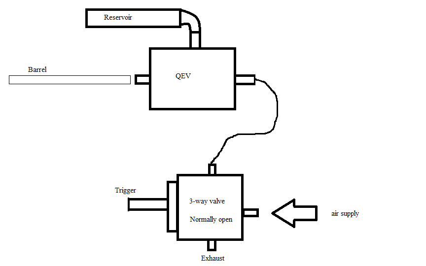

Just want to make sure I got the basic mechanism for full auto and semi auto right
basic qev and 3 way valve
semi auto.png (15.65 KiB) Viewed 1667 times

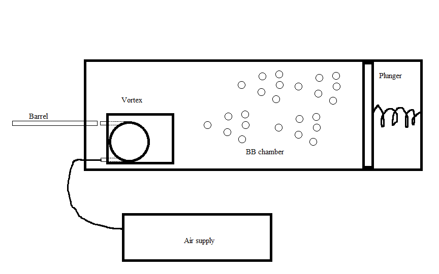

inline vortex block with plunger. Is the angle between the airsource and barrel correct?
Full auto.png (15.21 KiB) Viewed 1667 times
Mon Dec 05, 2011 6:58 pm
yeah, that's right... though if you can build a circuit that turns a solenoid valve on/off in a loop you can build a fullauto QEV + 3 way combo

Tue Dec 06, 2011 12:44 am
bookyle wrote:I'm not sure what you mean. Can you explain it in more detail?
He means that if you use a solenoid 3 way valve in your second diagram that is electrically operated, you can make a timer circuit that converts it to full auto.
Also by slightly modifying a QEV and using a pop-off valve as a pilot, you can get it to cycle full auto as in my recent example:
