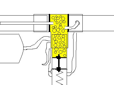

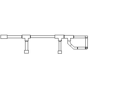

I am starting comsruction of this gun already. It will be a vertically spring-fed cloud design that runs off a tank that I forgot to put in the first diagram. The tank will be about 1 foot of 2" PVC attached to the gun, maybe with a hand pump attached. I wouldn't want this to be powerful, just for playing with my friends.
EDIT: oopsies, put the whole BB chamber yellow. Oh well, too late to change it now.

forgot to draw the blowgun and hose and tank in this one

ehh, spring fed? How would it work as a cloud if all the bb's are crammed tight into that tube by a spring?

i need more explanation. why is it spring feed.

yeah what's the deal with that? I think a good idea would be to have a slim co2 tank either 9 or 12 oz encased in a stock to provide air. You make interchangable cloud tubes. Shoot one through and just screw on a new one to reload.

looks like It could work, but the mag needs revision. take out the spring, or put a very very weak one in it. . oh, btw, what is the pic in your avatar, noname?

It's spring fed because it's not actually supposed to be a cloud BBMG. I didn't want to have to make a magazine that fit into the tubes I use. I made it that way so that the BBs are already in or near the barrel so if I squeeze the blowgun onncefor just a little amount of time, it'll shoot only one or two BBs. I'm not going to put a CO2 tank on because, 1, I only have 20 ounce tanks, and 2, I really don't want to buy a regulator right now.
