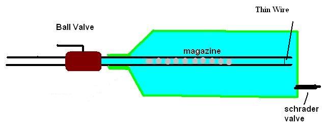

Solo
Posts: 33
Joined: Fri Jan 05, 2007 10:45 am
Wed Apr 11, 2007 1:04 pm
It's really quite simple. I drew up the basic thing w/o the 1/2" PVC housing I actually would probably use if I built it. Let's see if this works:

What's to keep the bb's from coming out that air hole? And I'd think the compresed gas would most likely escape from the same hole and rob power from the bb's.
EDIT: It also appears that you would really ned to line that ball valve up perfectly and quickly in order for them to pass through. That might be difficult.

Solo wrote:It's really quite simple. I drew up the basic thing w/o the 1/2" PVC housing I actually would probably use if I built it. Let's see if this works:
Edit: hooray, it does! It's kinda grainy, though, but I guess that ought to do.
yea nothing keeps bb's from going out back or through air hole, which is useless and acualy would be bad for performance if you were to put bb's behind it.

or you could put a couple of small air holes behind the all of the bbs and then when you open the ball valve all the bbs come flying out at once like a shot gun :blob5: that would be cool

Or you could just leave a hole in the back of that tube. Put two tiny holes through it at the back and thread a thin piece of wire through and tie it to itself. This would prevent the bb's from exiting the back of the tube and allow for maximum airflow. That still doesnt solve the ball valve problem though.
Try something like this.

paaiyan wrote:Or you could just leave a hole in the back of that tube. Put two tiny holes through it at the back and thread a thin piece of wire through and tie it to itself. This would prevent the bb's from exiting the back of the tube and allow for maximum airflow. That still doesnt solve the ball valve problem though.
yeah, lol idk why ppl thiink extra holes do anything at all to help.

I don't know, my thought is that hole towards the front will allow the air to escape the barrel and leave the bb's relatively unscathed.
Wed Apr 11, 2007 11:22 pm
no need for any extra holes, just make the magazine pipe of a slightly bigger I/D (say 8mm)
