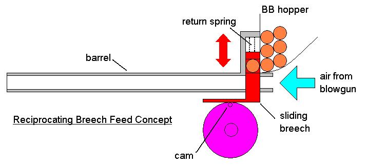

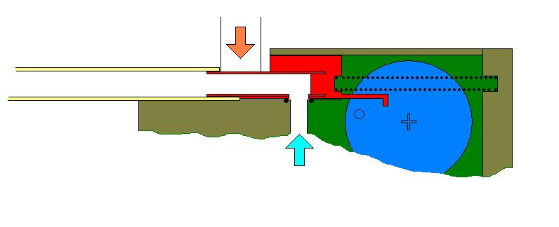

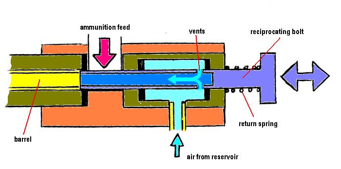

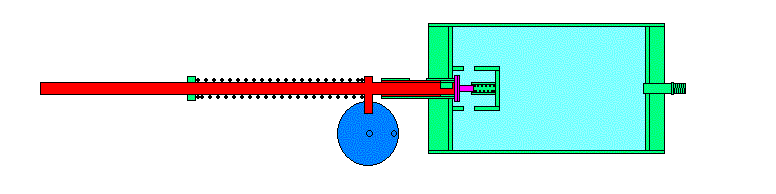

This has been one of my design goals for years now, I think the best idea I've had is to use some sort of electrically powered rotary or reciprocating breech, that allows you to vary the ROF according to the motor's RPM:rogntrude wrote:I want machine gun speed but NOT 200 a second! any ideas here?
Never built the prototype though, as ideally the system would not need an external power source. I guess you could substitute the electric motor for an air powered drill.
Some other thoughts I've had on the subject:
