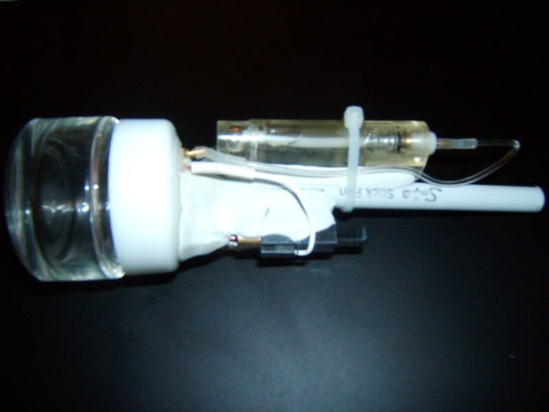

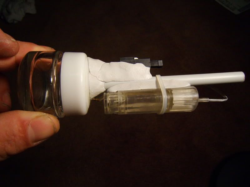

My new toy. Bored saturday afternoon + fiance finishing off a bottle of eye cream or something+ marine putty epoxy+ Old grill lighter+ center piece out of a piece of coax+ old bent sewing machine needle+ a little solder and shrink wrap+ a small zip tie=

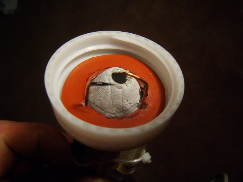

<a href="http://s117.photobucket.com/albums/o75/ ... CF3157.jpg" target="_blank"><img src="http://i117.photobucket.com/albums/o75/ ... CF3157.jpg" border="0" alt="ignitor"></a>

Two pulls on the fuel works just right. It will fire nicely about 80 or 85% of the time. I put a tiny chew mark in the breech to keep the bb in place until firing, and melted the end slightly so It won't push through when loading. Its a Scripto pen tube, fits the air soft bb's quite nicely.
This is my first mini-combustion, and second combustion overall. It turned out a lot more powerful than I thought it would be to be honest with you.
The base is clear glass as you can see. Its neat to be able to see the spark, and the fire ball inside when you fire it.
Let me know what you think, or if you have any questions, fire away....no pun intended..hehe.
