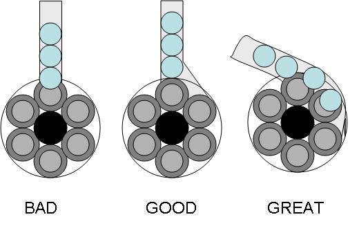

socoj2 wrote:Rotational issue with paintballs. I worked up some math this past month for shooting down the barrels of rotating tubes. ITs just not feasible. If you Are shooting down a 1.5" barrel so the ball doesnt clip the side and break. The fastest you can make it shoot is 20 balls per second. Granted this assumes barrles on a 2" diameter pattern and 1.5" in diameter.
socoj2 mentioned a legitimate concern, but I feel he was alittle ignored
I believe what he is trying to say is that in feeding the balls can't load fast enough and will get cut up during feeding, the solution is that feeding can not happen a very limeted sharp perpendicular angle
gatling paintball feed.JPG (26.97 KiB) Viewed 4234 times

No what i am saying has nothing to do with Feeding.
