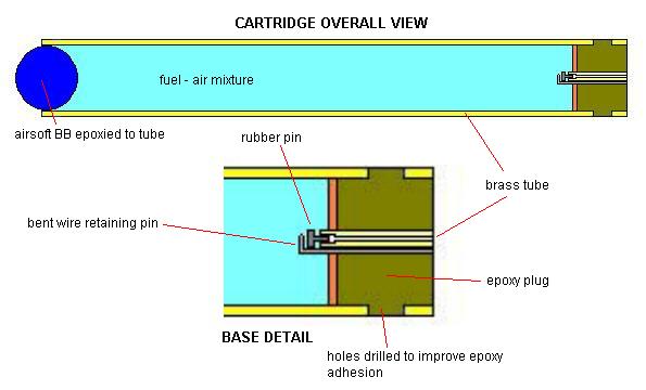

I always wanted to make a tiny hybrid to use as a compact and powerful cartridge - small scale fuel metering is a bit of a [female canine] though...
Here's a design I had posted on spudfiles:
- I had actually built this design but never managed to get it to ignite. I might give it another shot some time in the future.
- brasscart.JPG (26.09 KiB) Viewed 5208 times
