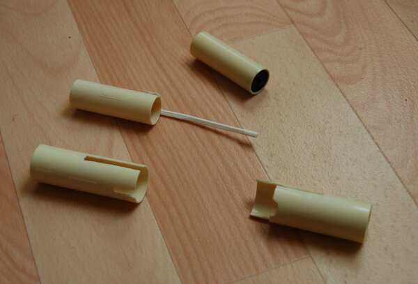

Here are some pics. Next step is to build the magazine holding area which holds the assembly together shown in the 1st pic. :)

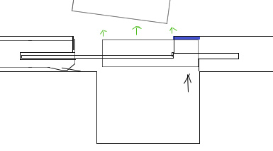

When the bolt moves back it hooks the empty case along to a point its ejected.
parts
parts

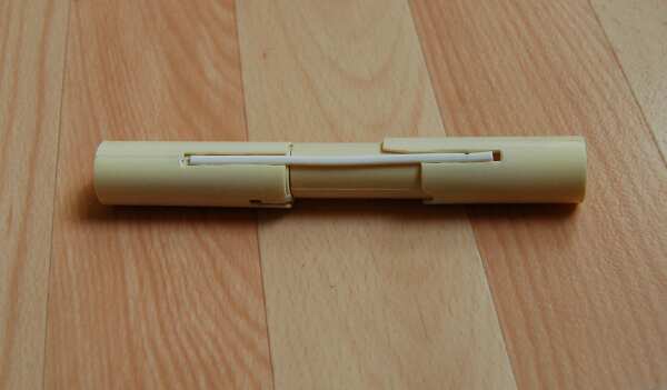

Complete assembly
Complete assembly

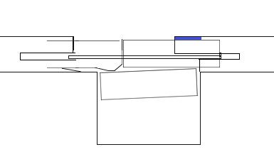

After the bolt moves back, the empty case will be pushed out by another case below uhm like this (got my picture order messed up)
The hook part is quite flexible allowing the new round to move between it. The hook will eventually snaps into place when bolt is moving forward.

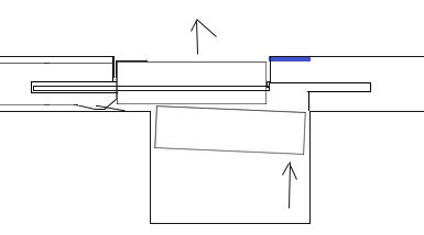

Case ejected by the upward force from the new round below (magazine spring).
bolt pull back with the empty case

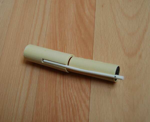

loaded round
loaded round
