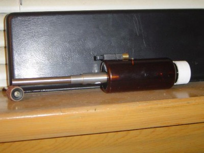

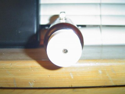

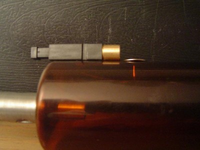

HEY ALL, I have a question for someone experienced here, SORRY I'M A NOOB, but I wont be for long. Anyway I just got started with this spud gun thing and I figured I'd start small before I go BIG, So heres the question. I made a Mini-Combustion cannon as seen in attached pics, it is a prototype just built in like an hour and easily disassembled for tweaking, but for some reason it will not ignite the fuel. For fuel I use butane, as seen in one pic I inserted a butane fill valve in the cap of the bottle for easy fueling :), but for some reason I cant get the fuel to ignite. I used a normal lighter Piezo ignitor and it jumps nice 1/4" sparks so I doubt it's that, and when the cap is off it will ignite sometimes so I figure its not getting oxygen, what could I do to remedy this so I can get it to fire before I build a sturdier one? Different fuel maybe? ANY comments are greatly appreciated!
Close Up of Ignition System
Butane Valve In Cap
Butane Valve In Cap
Side View
Side View

The concentration of butan must be around 5% not 130%.You may use metanlol or ethil alkohol.A few drops.After fireing you must vent the chamber.
PyroManiac.666
Posts: 9
Joined: Thu Feb 23, 2006 1:24 am
Thu Feb 23, 2006 4:53 am
OK what do u mean 130% i'm not retarded. when i use the butane i barely let any in, and i always vent the chamber by blowing air thru the back out the barrel to get fresh air in, but on another note, i HAVE gotten it to fire very reliably with very small amounts of CaC2 (AKA Calcium Carbide) and water (CaC2 reacts with water to form ACETYLENE GAS), similar to a toy bangsite cannon from the old days, and boy does it make a nice flash and flame out the barrel!! :twisted: I may post a pic or vid of it firing if i can.

I just use a disposable ligther with a hoseon, put it in there and let 5 secs off. If not use cologne, although if you use liquid fuels you will have to clean it after use, the residue is a bi#*! after a while.

You may use H2 instead of H2C2.It is easyer to make.Or petrol and O2 but with safty glasses on.The air from your month isn't wery O2 rich.

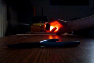

Hey I figured I'd post a pic of it firing, not much but you get the idea, i was able to pull of 5 consecutive shots, (3 good ones) without venting b4 the CaC2 was used up. Not too shabby i think! :twisted:
Mean glow, small jet flame out barrel not cought so well by my camera.

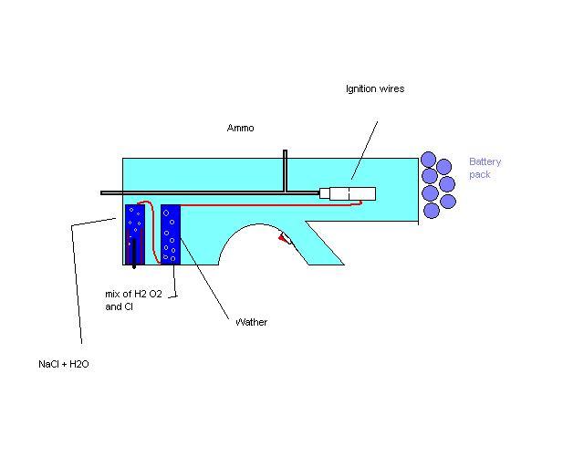

The acetylene make a higher tempreture then the butane and axe.It also lights in lower tempretures=> it don't need to be in the right proportion.I think that this sucking effekt wich I well know too, suks.This was a very nice gun months ago beafuore ....It was compleatly destroed..
H2 gun.JPG (19.22 KiB) Viewed 3559 times

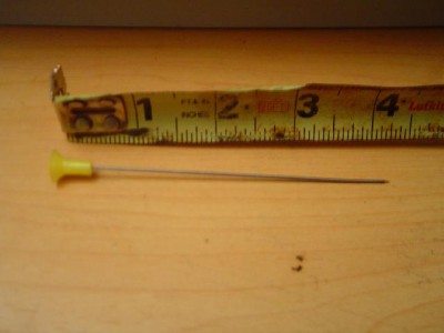

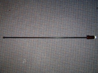

OK, I had to try this out. I slightly modded my mini by replacing the .177 caliber barrel and adding a 36" .40 caliber blowgun barrel. To my surprise not only did it launch the needle dart incredibly well, it buried it 3/4" into SOLID pine from about 5 feet. I was amazed as I can barely get one to go in 1/4" with lung power. I cant wait to try it with paintballs. :) I attached a pic showing the new addition. SWEET :twisted:
P.S. I used cologne for fuel and the chamber volume is about 4.6 CI.
Modded Mini
Modded Mini
This is the dart that went 3/4" into pine.
