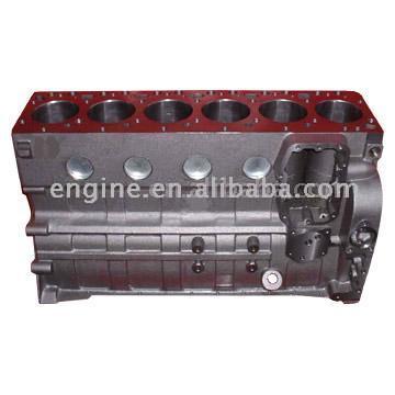

I have one problom with this.
Have you ever seen how thick cylinder walls are on a diesel engine? Everything that you have pictured are piston sleeves, which are not designed to harness all the stresses of the cumustion process, they are just a smooth surfuse for the piston rings to seal aganst.

It is unlikely that a detonation will damage an engine block, which is at least an inch thick at it's thinnest point, but detonation is well known in the automotive world to cause severe damage to the much thinner piston.
Also, pyro, your comparison is invalidated by the fact that almost all engine blocks are made from aluminum, which responds differently to detonation forces than steel.
