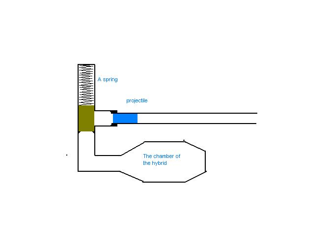

Am I the first one who tought about this idea?What do you think?Will I blow my self?How about an auto hybrid?
rambos' burst disc.JPG (13.77 KiB) Viewed 3143 times

I'm pretty sure you're not the first to think of this. I've seen one with a similiar idea, different layout though. The problem with a spring is that if it's too weak the piston will break, if it's too strong the valve will close to quickly. The sharp 90 degree turn might not be safe.
P.S. One, there's no "burst" or "disk" about this. Two, this is basically a big pop-off valve.

The imbportant is that it is for hybrid.I'm planing a hybrid shot gun.

no spring if hybrid, charge the top with the same pressure of air as the chamber

I made this a long time ago.
http://devinexecution.com/airpower2/det ... ode=search
comments are in dutch but it's the same principle.
A pop-off-valve-hybrid..

Atlantis wrote:The sharp 90 degree turn might not be safe.
I think that it is safer then a coaxial hybrid.About the shot gun- my plan is much different.It will use AA batteries.

brian i need a translation on that picture
Rambo
Posts: 509
Thu Apr 06, 2006 11:50 pm
Me too.Why there are two holes on the back of the barrel?
Netherlands
Posts: 3497
Thu Apr 06, 2006 11:56 pm
The holes is where the pressure enters the barrel after it's released.
