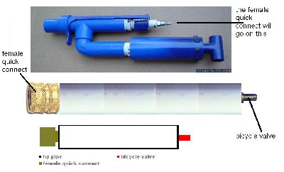

iv thought of this design. deh quick connect could be something els, buth o don't know what:S

you might not get allot of shots out of that

The idea of a compressed air CARTRIDGE is to use it for one shot only, then replace it with another one :)
@taz22: that being said, why would you use a semi auto piston?

i'v used tis 1 becaus it was the 1st gun that came up in my mind, with a male quick connect:D
