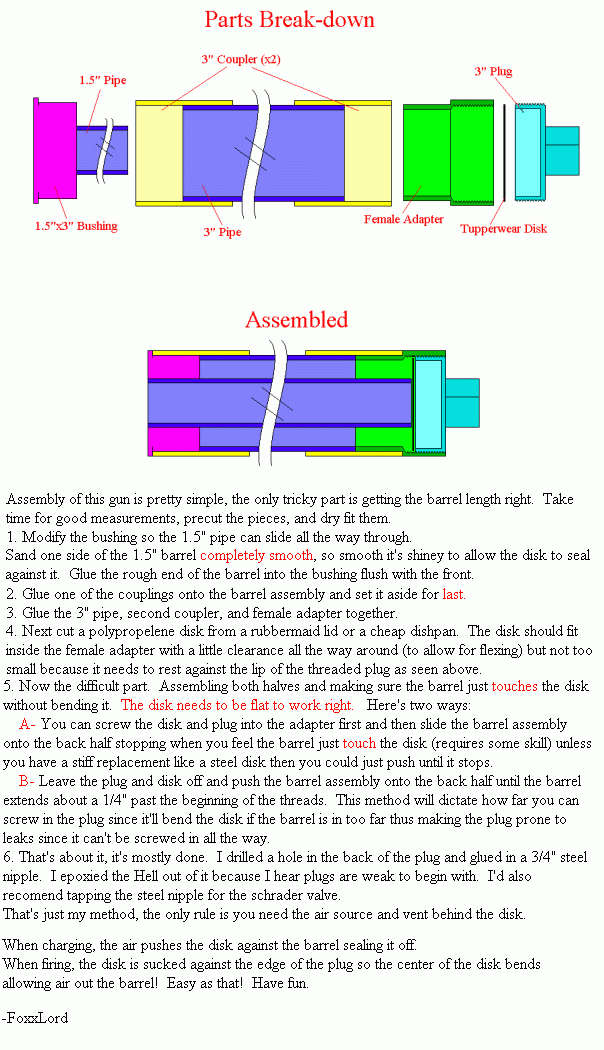

<div align="center">PUNISHER VALVE
Provided By FoxxLord - <a href="http://www.geocities.com/cain333_2000/" ... 3_2000/</a>
<img src="http://www.spudfiles.com/official_pics/punhow2.gif">
Provided By FoxxLord - <a href="http://www.geocities.com/cain333_2000/" ... /</a></div>
Punisher Valve

what does this punisher valve do
It's a barrel sealing diaphragm valve.... It seals the barrel off from the chamber and you fill the chamber up with pressure and then you uncrew the end cap I believe and the air rushes into the barrel... I didn't read it so I'm not sure, but I'm guessing from the look of it...
