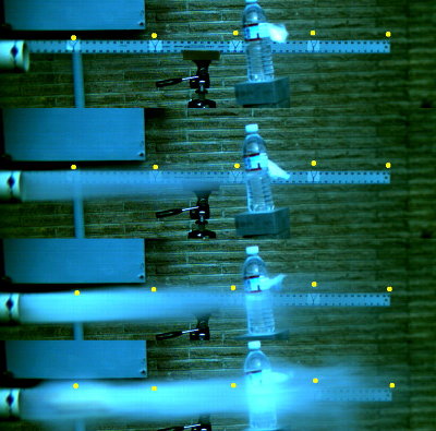

Thu Sep 10, 2009 6:19 pm
jeepkahn wrote: I've gotten true chrony readings in excess of mach 1, but that is still debated, BUT, I was using an efficient piston valve and several hundred psi to achieve it.... And even at that, I won't say beyond a shadow of a doubt that I achieved Mach... I believe I did, but science says otherwise unless I got lucky with my chamber barrel transition...
I'm hoping to use an oversize valve for subsonic flow into a transition into a smaller barrel with Mach 1 or close to it in the transition and then supersonic in the barrel with expansion of the pressure.
What I am finding from NASA shows this is possible for light projectiles and gas flow. My early high speed video seems to indicate I have already had some supersonic flow, but haven't clocked a projectile there yet. I seem to have reached about 1.3 to 1.4 in flow from frame to frame mist advance at 1,000 framse/sec.
Sequence from high speed video. Frames are 1,000/sec. I highlighted the one foot marks.  Is it moving faster than Mach 1?  In the bottom frame, the lump is a broken apple.
