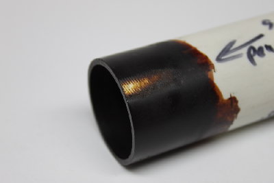

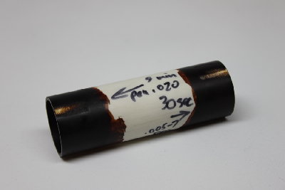

Anyone dyed PVC before? We've been experimenting with some dye formulas and stumbled on something that seems to work quite well.
Check out the pictures...

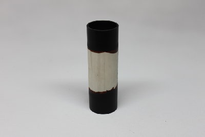

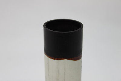

You notice that 5 minutes in the Dye gave .020" penetration, and 30 seconds gave about .005" penetration.
In the 3-5 pictures you can see we filed of some of the dyed PVC to show the depth of penetration.
Opinions?

test 1 1/4 PVC SDR-21 x 5"
.020" dye penetration dipped for 5 minutes
.005" dye penetration dipped for 30 seconds

does it affect strength
It does soften the outer layer a bit, but hardness returns after sitting a while. I think that strength is unaffected once re-hardened. We are using some of the same components found in PVC primer (MEK).
We have not actually tested to see if it weakens.. Maybe a hydro test is in order.
How long does it take to dry?
How well does it bond to the PVC (can it be scratched off easily)?
Looks good though, I assume you can get more colours as well
The 30 second dip only took an hour to harden up, the 5 minute took 24 hours. I think 1 minute will be optimal.
the dye is penetrating so no it can't be scatched off, like rattle can paint. You will have to remove the outer layer of dyed PVC to see white again. If you look closely at the 30 second dip.. and, at the top, I scored it with a razor knife. Normally it would flake the paint off.
We got black to work well, cause we use it a lot. We will be working on other colors.
