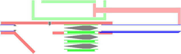

a 12 frame animation for you, flex the muscles of my renewed computer...
btw, click on it
the green things are shells/cartridges made of 1/4" OD brakeline
the light red is a 1/8" npt nipple, it has a ramp and a slot for the blue grabber thingy
the blue is the barrel and bolt made of 1/4" OD brakeline, the bolt has a small grabber that slids in a slit in the red
the green box is a modified air cylinder, it will exhaust all the gas when fully open, this cylinder is filled from the exhaust/pilot of a QEV or similar valve, the grey lines in it is a spring
the valve opens to the blue bolt where the 90 degree elbow is, this will need a flexible tubing
you might notice that the green shell might fall out during loading, that is why the ramp is there, so it might fall a bit but slide back to horizontal.
the grey is the ammo, best be a alminum peice put on a drill press and filed to a areodynamic shape
oh u can also have the mag on top and forget the grabber on the bolt, but somebody mentioned austrailian guns and line of fire so... on the side maybe
barrel is ment to be fitted with a little help from epoxy, puddy or jb weld, whatever

I am a little confused on how the blue barrel/bolt is supposed to fire at the right moment when the shell is lined up.
Good animation. The design could be built.

when they are lined up, or when they are just about to, the red piston reaches a point where it dumps all of the gas, meaning opening a valve, synchronization is not very important because all piston valves have a small delay in opening time, and all of this is meant to happen fast
i dont think this should be tried with a metal projectile, maybe a plastic bb
this would definitly take some serious dremel work on the 1/8" npt nipple
oh and i did draw a few orings here and there, but i guess they dont show up good
i like simple things, so this thing is only to look awesome when firing, for real fun i'd still use my nail gun, you probably need a spring to aid ejecting and so you can point the gun down without things just falling out the barrel

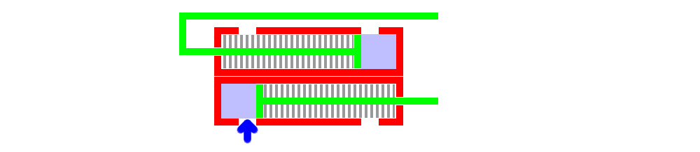

i thought of that too, either way there is a chance that the air might get trapped and the bolt doesnt return, depends on spring tension, or maybe another cylinder that puches back, and will start charging to chamber again only when it's full
i did this one in school so it sucks
Animation of 2 pistons working together, you can see how this is hard to work out

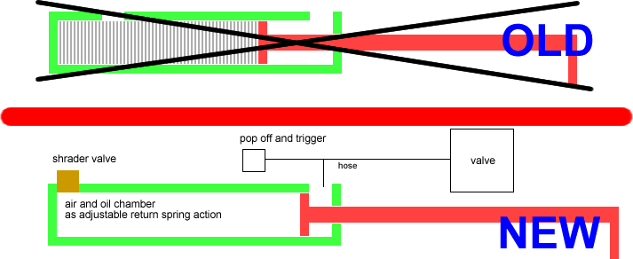

stupid me, i dont really need such a complex blow forward, instead use a double action, one end is filled with a calibrated amount of oil, add or remove to adjust return power, the one to be filled with air has a pop off
and i worked out a way to stop posible ammo jams

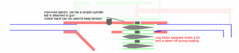

This is another similar design
click on it to see it good
note, the rearward rubber seal may be troublesome
also note some possible flaws have been eliminated
the shells should look like this, so they seperate themselves yet always stay upright, the slot in the 1/8" nipple has to be wide though

this looks pretty damn good, if you can figure all this out to work nice, you could get a pretty good rate of fire i imagine. the barrel movement alone would look awesome. i dont think you would need the ramp to help make the shell horizontal if you make the shell catcher longer and deeper, and have some sort of rachet type thing, that lets the shell move forward but would be knocked out on the return of the bolt.

i plan for a little pin to lock on to the shells, i will definitly take your advice into consideration, but i cant have it too long, since my 1/4" nipple is only 6" long, i can extend with a coupling but I would have to cut through the coupling too. how long do you think? anyways, once i do a test fire i'll know where to cut my ramp.
i made already bored out my 1/4" nipple with a 3/8" drill bit and cut out the ramp, this thing uses up 1/2 of a cutoff disk per cut
KVINCEO
Posts: 37
Joined: Wed Oct 04, 2006 5:03 pm
Fri Oct 06, 2006 9:28 am
wouldnt have to be too long, i was thinkin just a coupling, but i doubt if you would even need that much, just enought to hold whatever your shell for a little bit. that ramp looks alot better than what i was pictureing, and alot easier, but id definately consider a coupleing or somthing if the ramp doesent work out.
