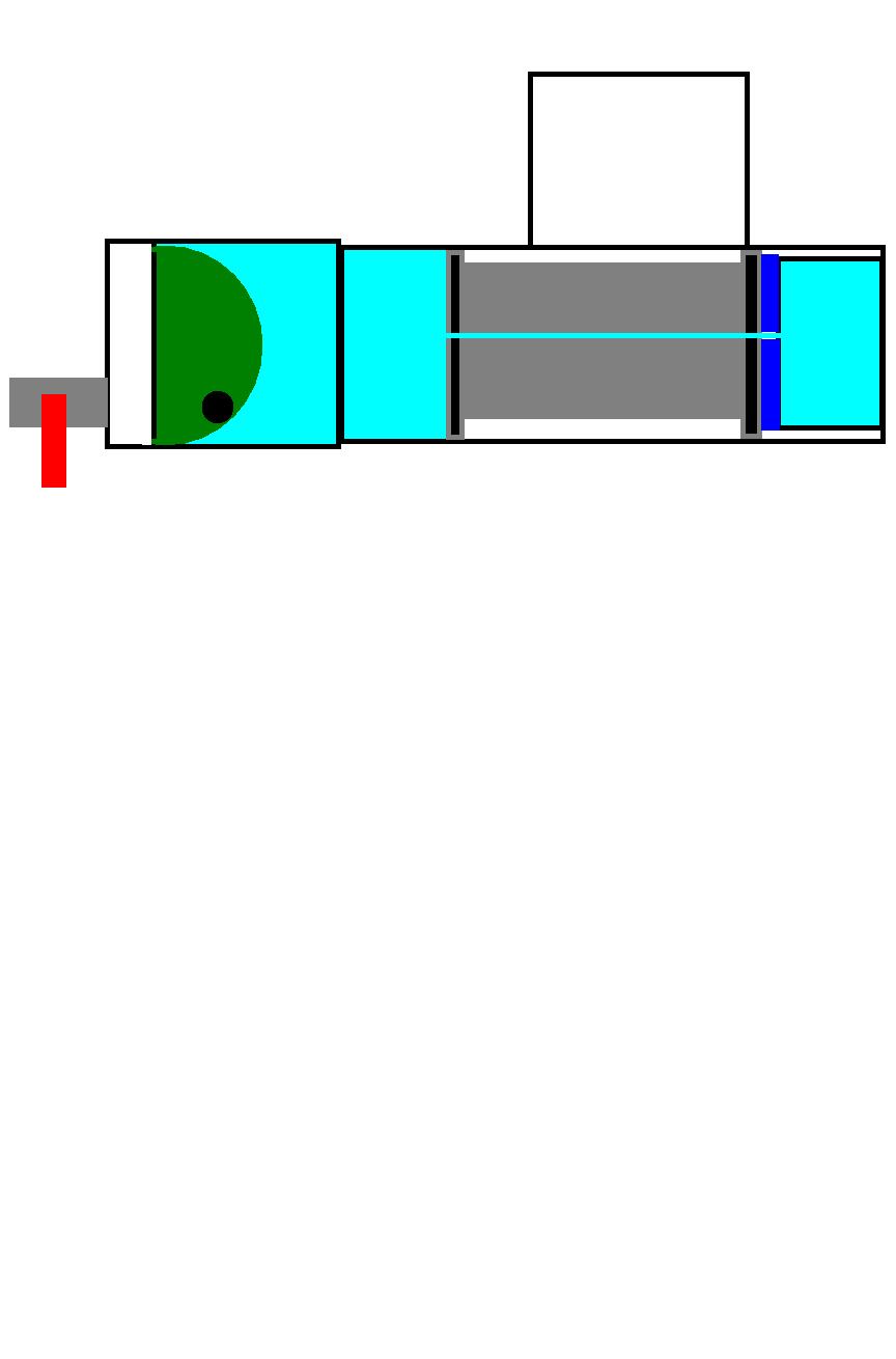

Yes yes I know its been done, Supah right? Tell me if you like it.
Light blue is compressed air, Piston seals with O-rings.
Pretty straight forward.

It should work, but tel me, why go trough all the trouble and make a chamber sealing valve, when a barrel sealing valse is easier to make, and bether, due to less dead volume.
Nice pic though !

Yes, the concept may be very 'straight forward', but you have abused to go into how your going to implement the given system. From what I can tell it looks as if on the 'left' side the pistons movement will be restricted in its stroke to the 'right' by the 'stops' in the tee, and 'left' by the bumper? Am I right? [The lip on the piston led me to that speculation. And I havent the foggiest on how you intend the sealing portion of the valve to work. It just bugs me on you diagram that you fail to recognize any variation in obstacles, and diameter. You just drew the T as if it was straight through.

pimpmann22 wrote: Yes, the concept may be very 'straight forward', but you have abused to go into how your going to implement the given system. From what I can tell it looks as if on the 'left' side the pistons movement will be restricted in its stroke to the 'right' by the 'stops' in the tee, and 'left' by the bumper? Am I right? [The lip on the piston led me to that speculation. And I havent the foggiest on how you intend the sealing portion of the valve to work. It just bugs me on you diagram that you fail to recognize any variation in obstacles, and diameter. You just drew the T as if it was straight through.
I will file out the stops in the tee. It will be well lubricated and should work very well. And god, this is a primative design. Sure point out the faults but it hasnt actually been BUILT YET! wait untill its done before you critisize.

You don't seriously expect it to make any kind of seal when you plan to "file out the tee" do you?
