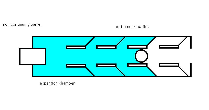

your picture is the design of your average store-bought silencer. I have recreated this design over and over and it still doesn't compare with my other design i showed you.
And the vent holes in the back are necessary otherwise the air doesn't want to flow through the silencer, the force of the air just keeps on moving and goes out the barrel, making the silencer pointless. I found this out when i made the silencer without the back vent holes and decided to drill them. best decision ever (pertaining to my self made silencers). lol

STHORNE wrote:Image
yellow = airflow
But why the exhausts at the back?
