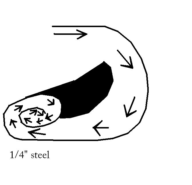

that is what i used for the marble gun, stood up to thousands of hits with bolts and marbles (yes i did shoot EVERY day)...
consists of a strip of 1/4" steel about 40cm wide that is bent after the pattern in the picture, two 1/4" plates welded to the sides so the projectile does not bounce out the side and some lead to keep it upright. the lead can be replaced with a bar welded to the bottom that you force in the ground.
simple to make and REALLY strong. you just need some tools. made in a an hour at a good shop so you does not have to pay much to get it made either.
i made multiple other models aswell but not a single one of them held up against a high speed golfball...
