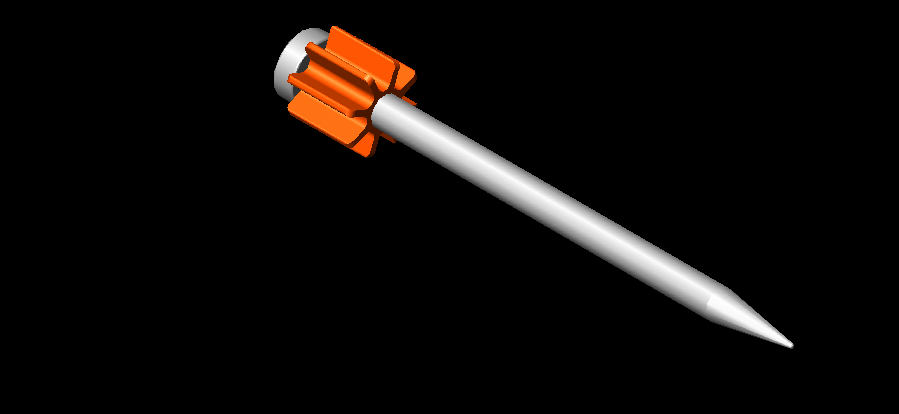

Here you go dewey... shaft diameter is .15", point taper length is .35", head diameter is .29", "fin" diameter is .405", fin/collar length is .35", collar "sleeve" diameter is .205"(when on shaft), head thickness of nail is .10", overall length is 3.10"....
Weight cg is rendered moot, even at 100+ yds they penetrate straight in, no tumble whatsoever...

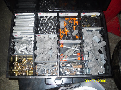

Call your local hardware store and ask for powder actuated fasteners...
They are hardened steel, and are used for attaching to steel I-beams and such...
The fins are actually collars designed to hold the nail centered/true in the barrel of a powder actuated nail gun...
you can see the ones I use in this pic of one of my ammo organizers...

Thanks for dimensions. I was all done drawing then discovered your reply
I will have to change my drawings.
Just the taper was way off on the nail.
I used .300 and .145 as the specs state.
My tail OD is 005 off. I used .400.
I have .340 instead of .350 for length
I have .185 instead of .205 for collar OD.
Not bad for working off a photo.
Here is the nail only. Click to enlarge
Ramset 1516 2.5 " Pin

Stu the real trick is the fins which creates a CP behind the CG of the nail.
I still would like to know the balancing point of your nails.
Maybe create a cookie cutter to cut fins in your pre-molded wax cylinders.
A thin walled seal could be put on the inside of the nail head prior to insertion into your finned wax cylinder.
I personally think $.10 a dart is reasonable.
Any way you look at it, you need a sabot or some means to keep the tip of the nail centered in the barrel.
