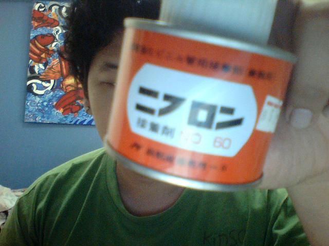

:oops: well it says Class E on the pipe then the rest got sawed off.. primer? well i cleaned the parts before use and im using Pvc glue... :cry: im sorry :(
heres the pvc glue im using .. i cant read japanese so i dont know wat to call it<br />:/
