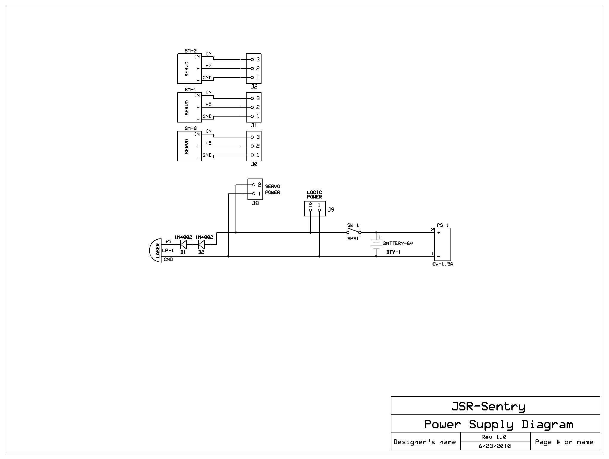

Another solution for laser power is just using 2 or 3 1N4002 in series to the positive lead of laser from external power supply. (6vdc-1.5A)
This will power the servos, controller and laser.
I will be sending JSR a schematic later today.
The only thing on the USB port will be his camera.

So, this is the 6V 1.5A power adapter I ordered.
Are these the diodes I want?
Also, one question, why is the battery still included in the circuit?
Thu Jun 24, 2010 12:25 am
The battery is used to provide the peak currents to accelerate the servos that the wall wart won't provide. 3 standard servos all trying to start at the same time can draw upwards of 5 amps total for a few tenths of a second. The voltage will sag and the electronics will go nuts. With the battery the servos just jump to attention.
It's like the lights dim momentarily when you start the vacuum, table saw, large AC or other large motor in a room. Servos draw a starting surge too. Average current is much less.
Standard servos draw up to 500mA each at stall on 5 V. Digital servos can draw up to 1200 mA on startup. High speed high torque servos can draw up to 2000mA each. This start current exceeds the wall adapter current you bought. Average servo current while running is in the order of 50-200 ma so you can calculate run time on a rechargeable pack while flying a model airplane. Average varies depending if you are running slowly like a thermal glider or doing aerobatics with a sport plane.

I figured it would be used as some sort of "buffer", will my current setup of 4 x 1.5V AA cells do or is there something better I can purchase?
Thu Jun 24, 2010 2:06 am
A normal RC receiver pack of the radio and 4 servos is designed to run on 4 AA batteries.

Wouldn't it be possible to use a large capacitor rather than a battery?

jackssmirkingrevenge wrote:Cheers for that Duane!
Yes those are the type of diodes to use. Can you get them locally?
I left the batteries in there as a "buffer" as tech mentioned.
Being you are using rechargeable alkaline batteries, you should be good to go without any other types of batteries.
You could try and remove the batteries once it is functioning, to see if you get any hesitations or false signals that would impair proper operation.
Hopefully you understood the schematic for the different control board connections.
If I got it correctly, it's just a question of wiring the AC adapter's + and - terminals to the current battery pack's + and - terminals respectively, yes? And taking the leads for the pointer supply from the same pack, with the diodes wired in series?
