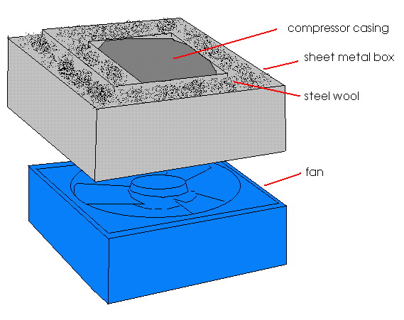

I still think an improvised radiator will suffice, using steel wool as Rag had suggested. At least it will stay dry :)

What is the purpose of the steel wool?
Compared to just having a fan blowing air over the casing.
It's got a lot of surface area but it's got very very little of that in contact with the paint of the casing.
It also restricts airflow somewhat.
Sun Jul 18, 2010 3:16 am
That's the point of the sheet metal, it would increased the contact area with the casing.
I've got something a little bit like your diagram, twin 40w fans on the ends in a push pull setup but no steel wool, it works very well without it thankyou :)
Like hotwired said I think adding steel wool would just reduce the airflow. steel is also a poor conductor of heat compared with aluminium or copper, would be hard to ceate a good thermal junction to the case with and individual strands would be too thin to conduct much heat away anyway. actually, I think you would just end up insulating your compressor :lol:

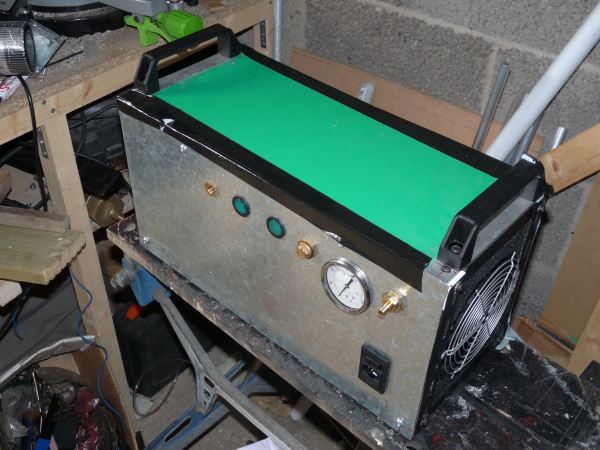

compressor nearly finished, need to replace the plastic top with some more metal sheet and she's done
Sun Jul 18, 2010 8:02 am
damn... that looks great :shock:
