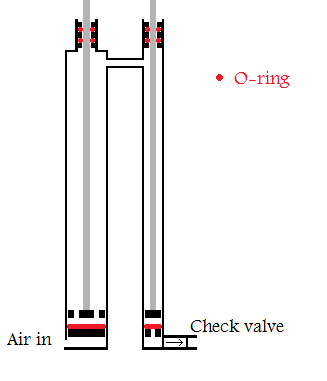

My point is if you're going to be doing this on a regular basis, you might want to consider a more efficient multi-stage design like spudamine's excellent creation - but they're your wrists, if it's comfortable for you then don't let me tell you what you should or shouldn't do

With all due respect, I don't see any advantage of spudanime's creation over mine. He's feeding lower pressure air into the second stage, and the second stage has a larger diameter.
Likely the greatest advantage he has over me is weight.

You've got it backwards, his animation shows the stroke cycle quite clearly - both cylinders pressurise the air initially on the upstroke, then the smaller cylinder pressurises this air further on the downstroke.saefroch wrote:With all due respect, I don't see any advantage of spudanime's creation over mine. He's feeding lower pressure air into the second stage, and the second stage has a larger diameter.
- pump1.gif (13.6 KiB) Viewed 2779 times
No, I don't have it backwards, and I did read the thread and stare at that animated gif for a while. I get his design. My comparison was from his to mine. Let me remedy this:
With all due respect, I don't see any advantage of spudamine's creation over mine. He's feeding lower pressure air than I am into the second stage of his pump, and the second stage in his pump has a larger diameter than the second stage in mine.
Unless my calculations are vastly wrong.

Thanks for rephrasing, I hadn't realised you were now injecting compressed air into your pump.
It would be interesting to see to what extent the upstroke pressurises the air in spudamine's design.

To me, it looks like the second stage is getting >4 Bar at the end of the upstroke.. I need to do the math to find out how much greater it is than one bar.
At the bottom of the stoke the inlet to the second stage is indeed near 1 bar. It is considerably higher at the end of the upstroke.
I estimated that he has a compression ratio, entirely based on the diameters of his pipes, of 22:15, which gives an approximated 22psi from the first stage which seems incredibly low, considering I use on average 75psi.
I did notice that he used two o-rings the top of his pump to seal, I'll try adding another and see if I get a 100% reliable seal there.

I figure that's incorrect in as much as the ratio should be based on volume and therefore the ratio is more like 12:5 so the pressure from the first stage should be more like 45 psi, still low compared to your injection pressure but higher than 22 psi.saefroch wrote:I estimated that he has a compression ratio, entirely based on the diameters of his pipes, of 22:15, which gives an approximated 22psi from the first stage which seems incredibly low, considering I use on average 75psi
