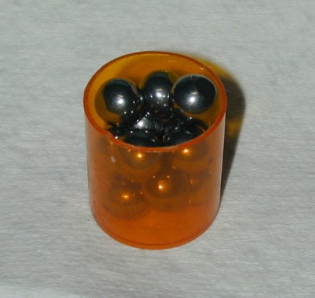

Here are the first two rounds that I tried in the one inch barrel.
They both use pill bottles as sabots.
The one on the left is a single steel shot 'stuck' to the bottom of the sabot, using candle wax.
The one on the right is the buckshot style. With paper towel wadded into the pill bottle on top of the shot.
Here is the "buckshot" damage.
None of the steel shots went through the plywood.
Pretty much each, the same damage as was done by a single steel shot from the half inch barrel.
