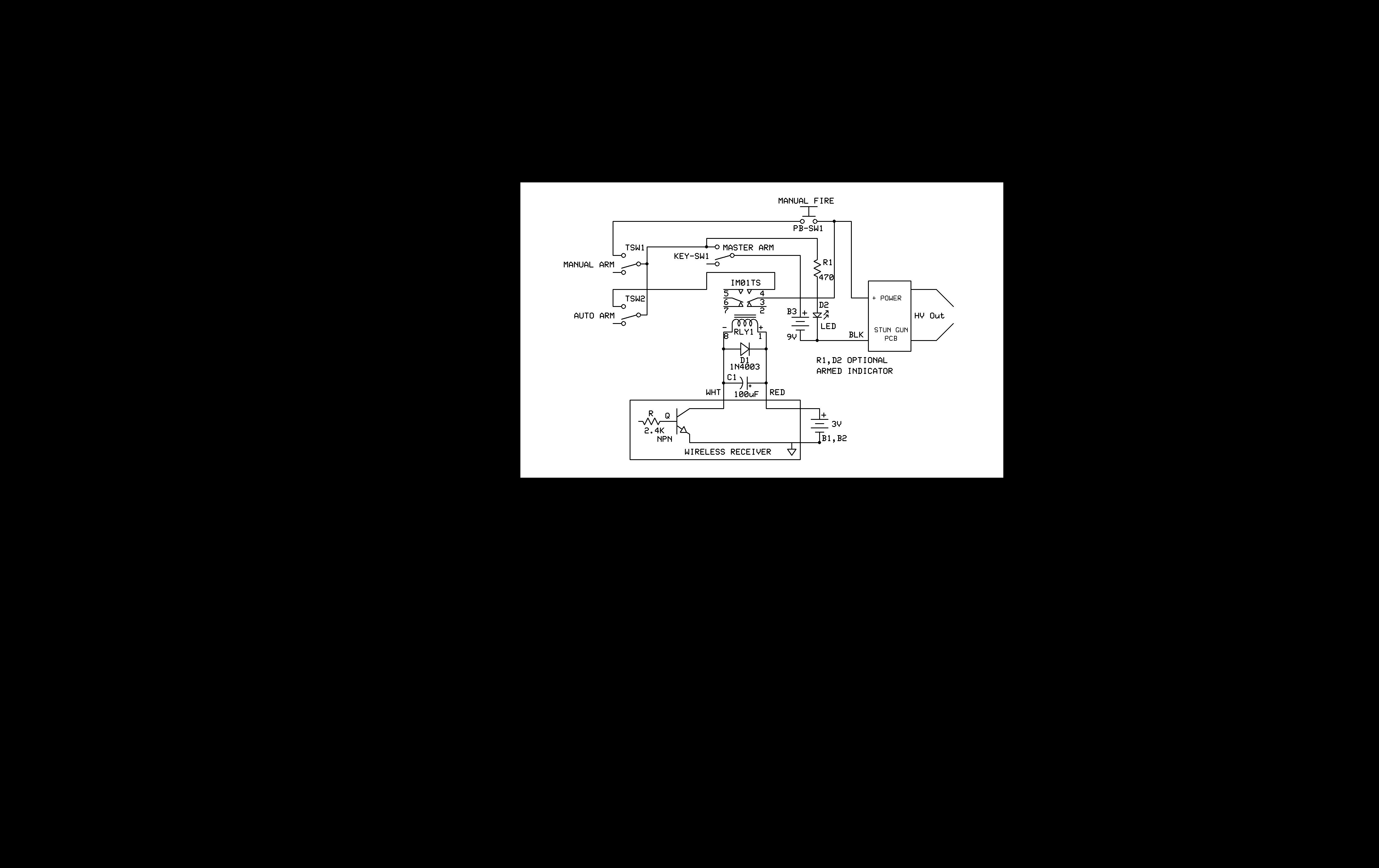

Here is a complete updated schematic for you MrC.
Sun Nov 13, 2011 1:16 pm
Thanks, I'll update it to the video, main page of this thread and instructable.
Edit: love the names you gave the components. Wish I had one of those printing label things so I could put "auto arm", "manual arm" and "master arm" on the project box :D
