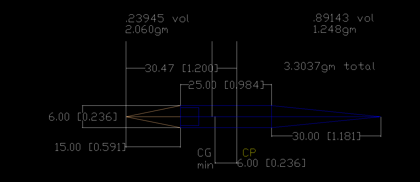

I drew it small scale because it's roughly the dimesions I intent to build it to, for testing from a 6mm pneumatic :wink:

JSR
The CP is 31.47mm from tip.
As long as the CG is 25 mm or less it will be stable.
Seeing as the nose is about 6 times heavier than the body, the CG will be quite a ways ahead of the CP point.

dewey-1 wrote:As long as the CG is 25 mm or less it will be stable.
CG = -23.622mm.
Mass= 4.535 grams +/-

Lol how are we getting different results ? :)
Is this with:
Brass cone 15mm long, OD 6mm
Brass cylinder 5mm x 5mm OD
POM 25mm long by 6mm dia, with 5mm dia hole x 5mm deep
POM 30mm taper, OD 6mm
Brass 8.6g/cm3
POM 1.4g/cm3
:roll: typical :)
Dewey how do you estimate the CP, are you using a function of your CAD package or some other means of working it out ?

Here are the results I got.
For CP, I just use the centroid of the whole projectile.
Basically the center of mass. (assuming the same material)
The CG is not calculated but a one caliber static margin is the minimum for stability.
I have not quite figured out how to get CG with two different materials yet or at least not with my CAD program.
JSR can give us the exact CG and weights when he finishes machining.
It would be interesting to compare the actual results to a 3D model.

Ok, in that case I get a CG 1.68 calibers ahead of the centroid.
And same total weight.
Indeed, especially as even the theoretical models so far seem to give very slightly different values :)
Mmm it would be interesting to get a measured value of the CP so we can work out a smuge factor for cylinder/cone shaped solids.
