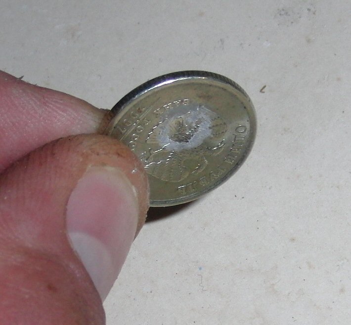

By the way:
Roughly how much energy were those two airsoft rounds carrying?
0.25 gram: 785 feet per second, 5.3 ft/lbs
0.12 gram: 918 feet per second, 3.5 ft/lbs
Doesn't compare to a hybrid but not bad for a mini pneumatic with a 7 inch barrel ;)
Edit: tried again with a (virtually worthless :roll:) 1 rouble coin and a 0.25 gram, visible dimple this time, and while there was no penetration, the clear acrylic shattering behind the coin will attest to the energy transfer :D
