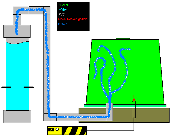

Does anyone think this would work? Ive been messing around with electrolysis for a while now and I want to have a fun(loud) time this 4th of July without spending tons on fireworks.
This isn't what I would make it look like, as it isn't to safe set up the way the picture is. I would most likely have a hose setup running the hydrogen and oxygen into the bucket with a quick connect on the electrolysis chamber so I could disconnect it and bring it away when firing.
- elect.PNG (17.36 KiB) Viewed 4199 times

Shadowscion: What you've drawn will work. The fuel / oxidizer ratio will be off since the bucket starts out with 20% oxygen in it but it should still ignite without any problems. You are just going to let the excess gases "burp" out from the bottom of the bucket?
Don't forget to disconnect the generator from the bucket before igniting! You'll have an explosive gas mixture in the generator and pipe, don't want the flame running back up the pipe into the generator.
You will want to have the largest electrode surface area as you can get, and you want them as close together as possible (but no closer than the typical bubble size for your particular choice of electrolyte). Both of those factors affect the current flow, which controls the rate of gas formation.
You probably already know this, but Drano and other drain cleaners make pretty good electrolytes (they contain NaOH or KOH). The higher the concentration the electrolyte is the faster you'll generate gas. But, concentrated NaOH, KOH etc. is corrosive and dangerous. If you do something wrong you run a real risk of spraying the area (and you) with the caustic solution.
Sometime people use Epsom salts (Magnesium sulfate) as the electrolyte. Much safer. You can get a pound or two at most grocery or drug stores for a couple bucks.
Salt (NaCl) can be used also but it will generate chlorine gas which is pretty toxic. Chlorine gas is an oxidizer just like oxygen. Indeed, Cl<sub>2</sub> is a stronger oxidizer than oxygen. You will loose some of the Cl<sub>2</sub> to hypochlorous acid (Cl<sub>2</sub> + water) but your setup has excess oxidizer anyway so that probably isn't a problem. But again, Cl<sub>2</sub> is pretty dangerous stuff, toxic and explosive.
Have you seen this site;
Big ass water bottle launched like a water rocket using H<sub>2</sub> and O<sub>2</sub> generated in the bottle itself. Check out "Dean's Benchtop" (http://www.et.byu.edu/~wheeler/benchtop/hydropyro.php), the definitive page on electrolysis powered water rockets.
Play safe.
