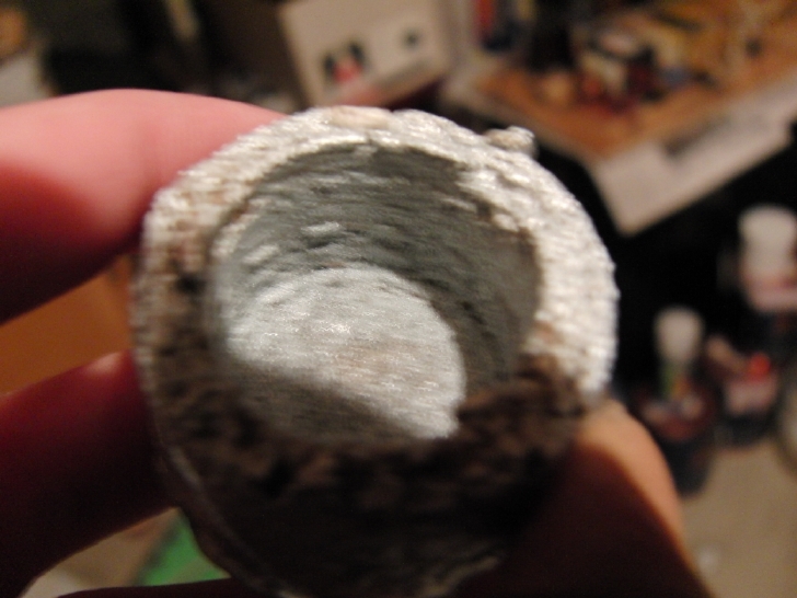

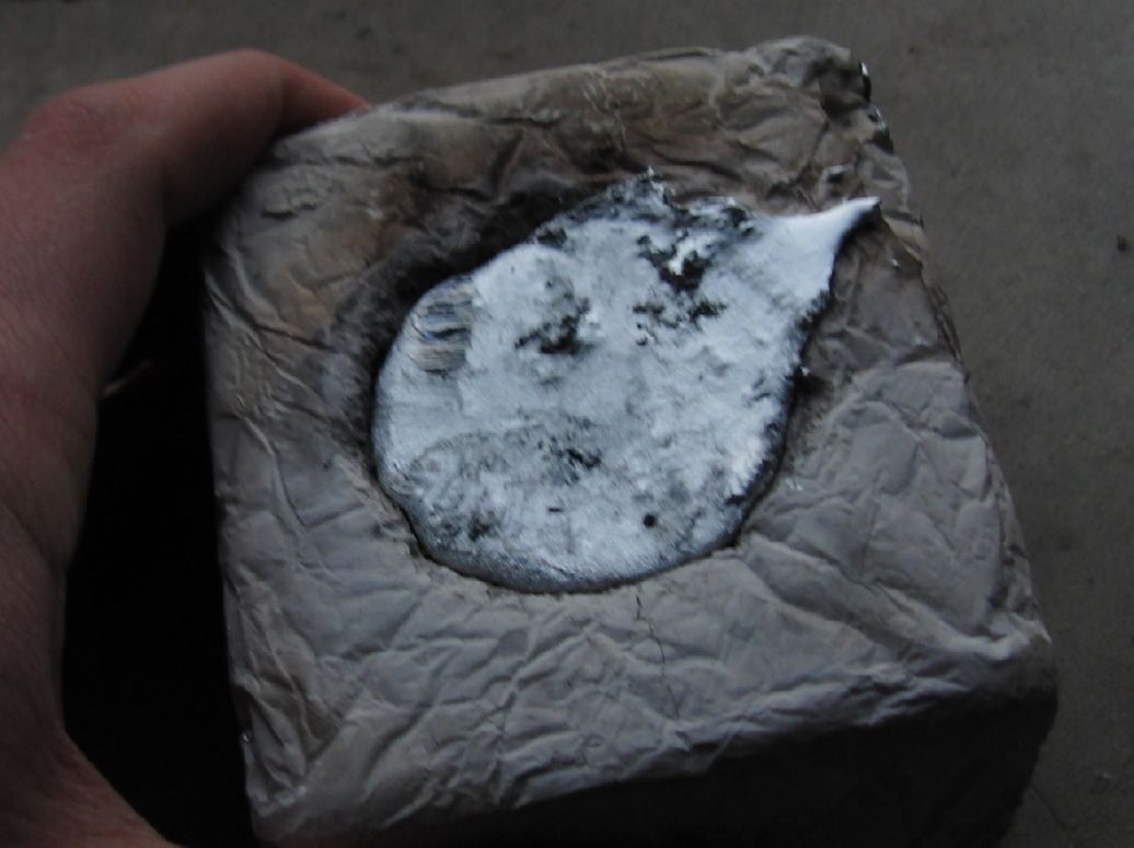

ITWOST, I cast a magic new part. It was around 150g of a zinc aluminum alloy, melted in a tuna can over charcoal with extra air provided by a dual action air mattress pump, with the second "action" broken. mold was a mix of plaster and sand. the mold broke while removing the original part, and it was repaired with more plaster. this was my first casting.
who can guess what it is and what is for???
in the mold
in the mold
magic new part
magic new part

Piston im guessing

I'm guessing piston (like Carlman) or vortex block.
