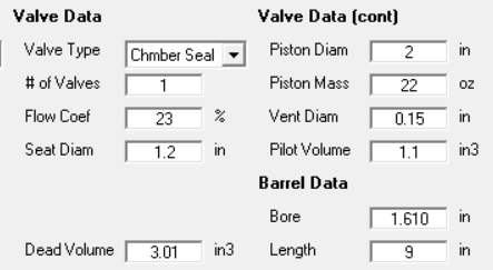

Does this look right for a modified 1 inch sprinkler valve?
I'm getting very odd results using the optimization tool (such as a 1 inch chamber to 100 inch barrel).

I'm going to hazard a guess that the diaphragm in a sprinkler valve doesn't weigh nearly a pound and a half...
Personally, I don't think GGDT's optimiser is fantastically useful, except in fixed overall length mode (maybe). It's perhaps an interesting lesson in efficiency, but trying to eke every last joule of muzzle energy out of the compressed air leads to launchers that are highly size inefficient.
It's like vehicles from the Shell Eco-marathon, where they try to do thousands of miles on a gallon of fuel. Technically interesting, but wildly impractical for every day use.

Cthulhu wrote:Does this look right for a modified 1 inch sprinkler valve?
That should be 22g (grams) not 22oz (= 620 grams) :wink:

Thanks guys, I feel like an idiot for not noticing such a small unit error :oops:
