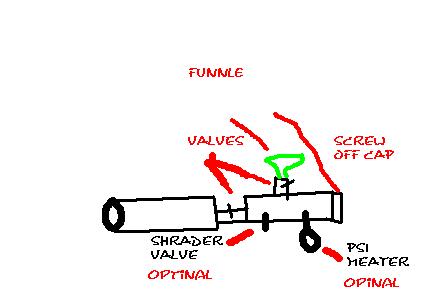

you could make a canonn that is a combustion phnomic and vinigar powerd lol, you can modify the valves into what ever u want , the funnle would be for poring down vinigar u would screw off the cap firs and put baking sodain . i recomend this for new people in spud guning it has a little of it all, i cant say it has the best ranger or power but it dose have it all
you could also add this if u wanted to
joe
i am not liable for anything you do with this
