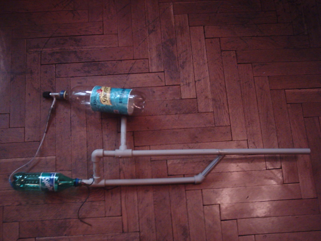

Why should we make thinks so complicated?Why do you think that the combustion will damage the ventig "sistem?".It never happend to me.My new gun uses alkohol=> no fueling "sistem".The oxidizer is mix of O2 and air so no missfires or week shots.The gravity feeding works well(sometimes it fires two in the same time but what ever..) it can be replased by bolt action.The complications will only make the gun unreliable.

I think others and myself still are not sure to as how your guns works. Could you possibly go over the steps needed to shoot it and possibly list components needed? Sure you proably explained it already with some detail, but I just dont have the "motivation" if you will to dig threw your 163 post to find out.
I just cant comprehend how it works, maybe because its to simple... At any rate, what keeps the whole magzine full of ammo from rolling out? (you noted 2 sometimes will shoot, but not the whole magazine) But a blow back mechanism could be added with few more diffculties. Thanks in advance. Im looking forward to your reply.

To shoot with the gun first I put 20ml of metanol with a sirilyk.Then insert some balls in the magazine.I connect the house (wich I used to fill the alkohol) comming from the small bottle to the valve on the bigger bottle.I open the valve and now small stream of air is venting the chamber.I push the trigger(wich isn't on the picture) and the fuel combusts.4 seconds after that it is ready again and I push the trigger again....until it run out of air.For semi auto I roccomend O2 riched air.

*still confused*
Ive asked several others and none of them understand exactly how it works. Maybe a diagram or a baby step how to would be better. Im super intrested in making a gun such as this, first I need to learn how it works... lol
sirilyk=syringe?
Were do you put the methonal?
Why both methonal and alchol when there both flammable?
Although I dont have the foggiest on how it works, could propane be used for the combustible fuel?

I don't think he uses methonal, instead he just presses the trigger, creating the spark and igniting the fuel. Then the air from the bottle vents the chamber as the alcohol(sp) evaporatesand until there it is the right ratio to combust, again.
Rambo: That is my understanding, if I got anything wrong feel free to correct me.

Sorry for the 'surulyk', yes it is syringe.Metanol=metil alkohol.No one should use metanol in close spase.The gasses from the burning are some kind of different(more toxic I think).I want to upload a video of my hybrid turning in to auto comb. I had a link but I coudn't upload to it.Can I have another link please.

Offcoure you can use propane but it will be very hart to get the right amount of air and propane in the same time.With alkohol it is awlays the right amount.I have only skype.I'm ramborambo8569.

No... Have you ever shoved a potato in a tail pipe? It seizes the engine. Rambo dont you have a diagram of how the cannon works?

I think Im starting to understand how this works...
You inject fuel into chamber, then you add oxygen. You fire and then next projectile falls then you simply put more fuel and oxygen in? So what happens to the exhaust of the last combustion? When you fire in fast succesion do the shoots get weaker and weaker?
If this is so, that would mean that your ROF is limited to how fast you can inject both the oxygen and fuel? What is the ratio for oxygen? And in such a design I would assume that propane would stay at its ~4% ratio? Im thinking about cutting all other projects to start on such a cannon, so im very intrested in your response.
