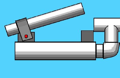

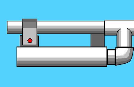

I've tried this type of breech in a gun (that can't be discussed because of forum rules)
without any rubber seal it was airtight!!! just metal to metal.I think it's because the way the barrel rotates..it can apply a lot of force onto the seal.
When done correctly it will "jam" shut, not needing anything to keep it closed.
The breach is closed.Notice the pivotpoint is below the barrel.
breakbarrel closed1.JPG (12.18 KiB) Viewed 4716 times

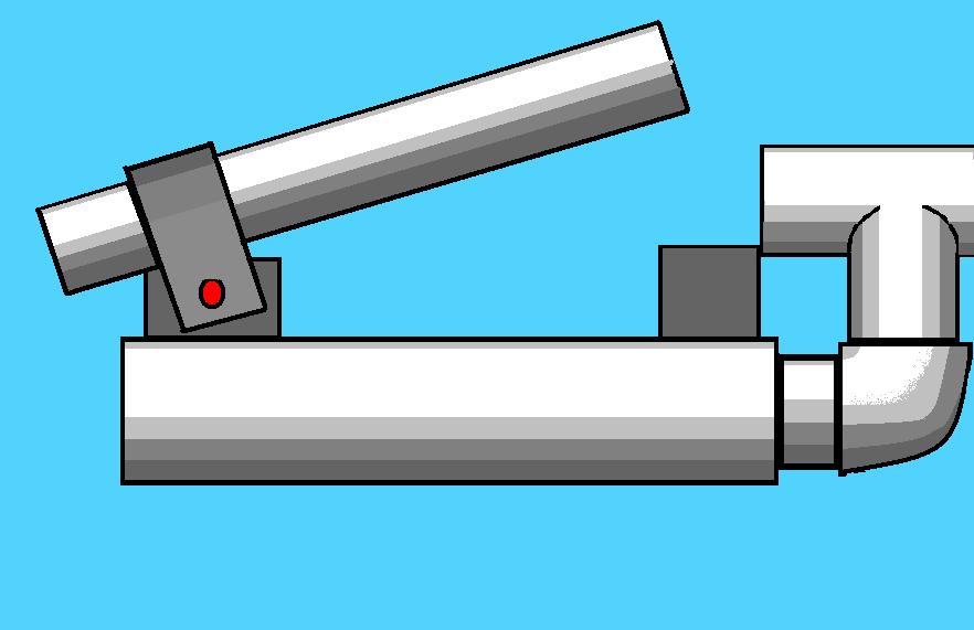

here the breach is opened.accepts very long projectiles this way

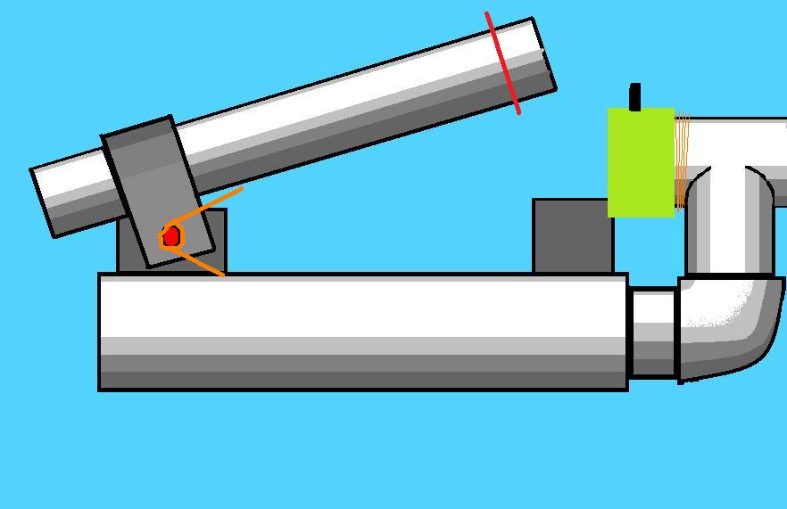

You could have a repair coupling behind the break with a spring behind it. The hinge that the barrel is attached to could also have a spring to open it when the repair coupling is pulled back.
One sec and I'll make a diagram...

Here are the mods I propose:
The green repair coupling is foreward, but when the barrel is pushed down the angle of approach will cause the coupling to be pushed back untill the barrel is fully closed, at which point it will move forward and lock onto the barrel under the spring's pressure

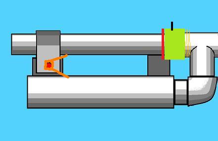

Closed, the green repair coupling is pushed foreward over the barrel by the orange spring. The orange spring at the hinge is in tension and will cause the barrel to spring up when the black bolt is pulled back (moving the repair coupling back)

ginsuguy is that design airtight because of the coupler. if it is Than i make it . Do you know good ammo fo 2in barrel i need that 2

wait do you need a coupling, do you use a coupling brian yet you say its airtight

A screw type coupler isn't needed to make it air tight but it does simplify the building and alignment.The type in the diagram will work but won't be as air tight as a screw on.
