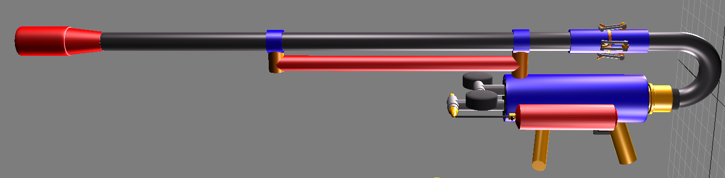

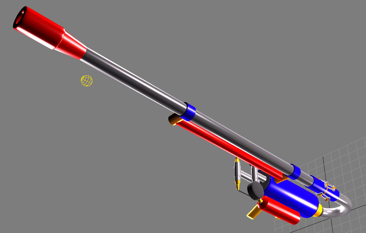

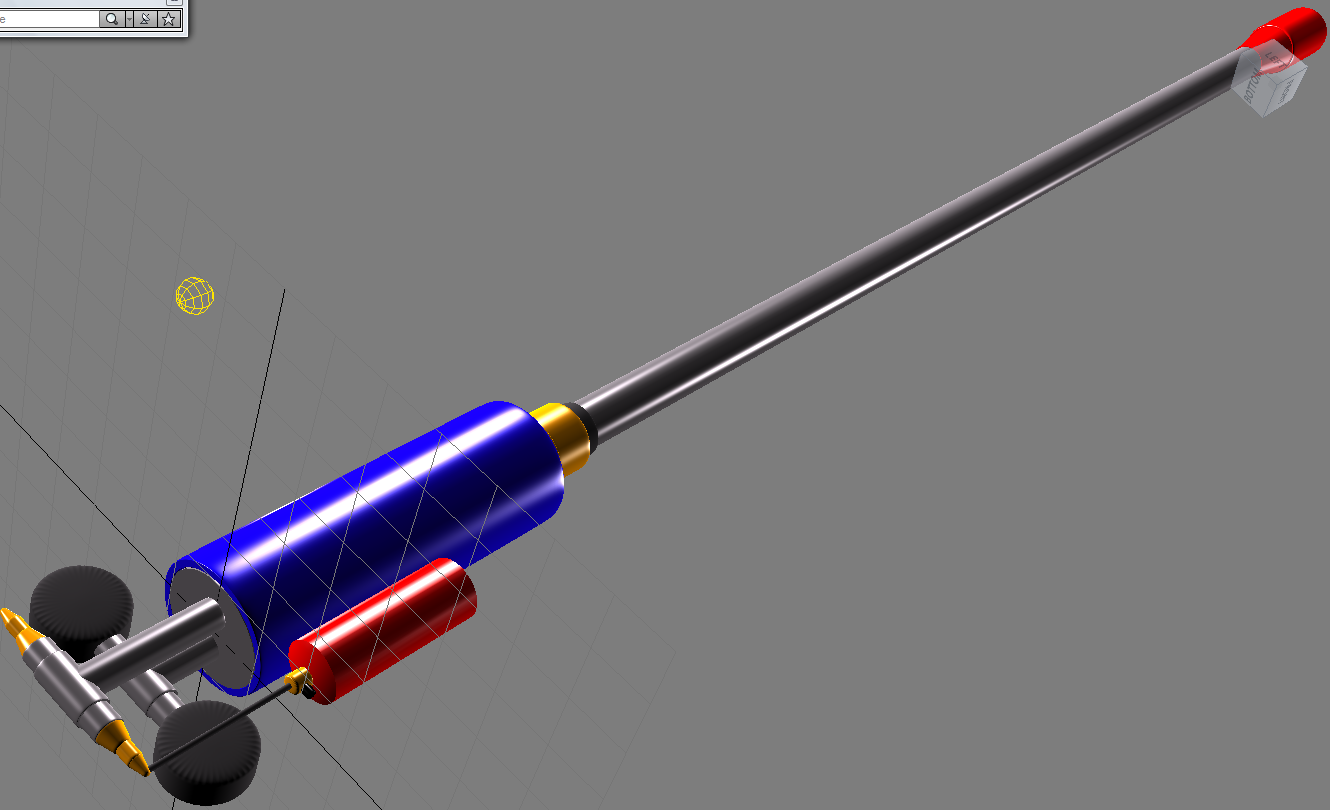

well i was playing with a 3D program today, i decided to make the dream version of UPGBH10x and it turned out pretty good.
does anyone have the resources to make something like this? there are some bugs that i could not find the solution to just now, like how sould i get the breech open.
it's a hybrid, valves turned out to be to difficult for me, first time i used the program. so the meter is a bit crappy but you get the idea.
much money, time, a powder coater and a machine shop is what you would need.
just wanted to share it.

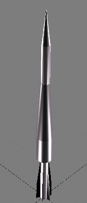

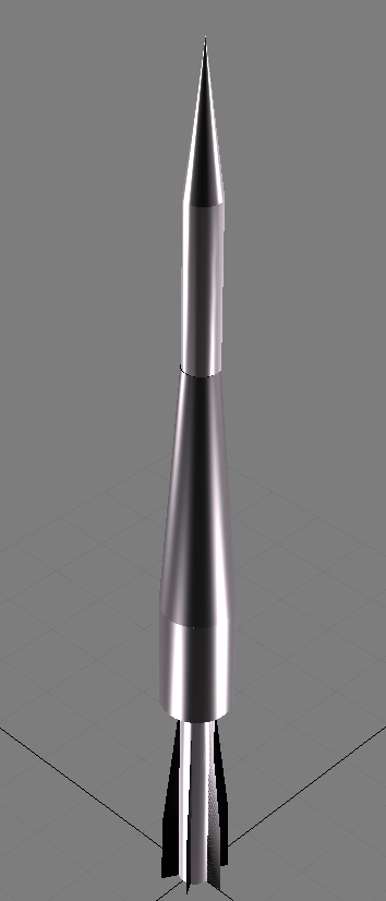

To be honest, the projectile would need some help. All those blunt trailing edges will cause turbulence, and one set would "hide" the fins from doing much. Other than that, I don't have any resources.

i know that the projectile has a flop there, and i am going to round it off tomorrow, now it's quite late here.

If this was assembled using schedule 40 AL (1.5", 2", 2.5", 4", 5" sizes) our rings, metering, and ignition would bolt right on. build your own rig with burst disc and bolt on our components for $600 +/- $100 depending on ring size.pizlo wrote:Hahahah ultimate spud charges 1000 dollars for a PVC combustion so this thing would cost... god I wouldn't sell my house for that.

The projectile isn't very good, besides looking very awesome.
You should have less sharp corners and the thick part in the middle should be placed more towards the front.

Thats a beautiful model! It nearly brought a tear to my friggin eye. I love seeing this stuff. I love the design. Couple questions...is that a standard return bend or are youn planning on hiring a tube bender?
Also, the barrel support looks like its cantilevering too much for sturdy support.
Is the support post welded? Consider that the chamber will be weak right there since the welding heat will anneal the material. Depending on your planned power use, you may have to re heat treat. It sounds like you aren't interested in building it though. If you were serious about it, you could also use the guys that made the Venom.
If there is no heat treating or anodizing required you'd save a pretty penny for sure. Nice design! I like it a lot.
Oh, what purpose does the muzzle brake serve? If simple looks, you could do without it and save machining costs.
The best barrel support for an over-under is the chamber
Uses a structure that's already there and doesn't need much dead weight to make the connections.
Some nice work with AutoCad there. Some of the parts there look a little generic though. Have you figured out the real world parts and interconnections that would make this thing real?

Right. Its a lot of fun to let the immagination run wild on a sweet design, until you realize that 95% of the parts don't exist.starman wrote:Some nice work with AutoCad there. Some of the parts there look a little generic though. Have you figured out the real world parts and interconnections that would make this thing real?

if i do build this i will take my time and get it right, i have accses to a machineshop, but i does not have the skills to do everything on this thing yet.
the barrel will be bent with the pipe bender on the shop.
the welding on the chamber is no problem, it is welded before and has 2" thick steel endplates.
if this is the last post when i get home i will edit it to tell more details but i am currently doing an exam
oh, BTW, the muzzlebrake is just for looks. i may drop the goodies first and put one part of a tim on later IF i build it.
thanks for the comments!
