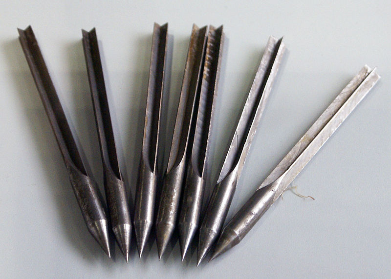

psycix wrote:I'd stabilize them using fins, not using a hollow back (lots of length without much weight and kinda much drag due to the square back)
Though for fins, a lathe is not enough.
An idea that I once had is to build a projectile made from two smoothed cones (a bit raindroppish) which screw together, one steel, and one aluminum. The lighter aluminum part would act as a tail.
Actually, fins are quite easy for a competent lathe/mill operator, think of it more like 4 deep flutes and you'll get the idea...
someone awhile back posted some flechette pics that illustrate what I'm refering to...
found it on wiki...
they wouldn't have to be this long, but you can get a good idea of the method of manufacture...

Those would need to be saboted, i want ammo that has the following attributes:
1.Can be used as is and can be quickly reloaded, no sabots ect.
2.Is extremly cheep to make and is quickly mad ein large numbers, having free acsess to lead i want to be able to shoot 500shots without feeling bad about wasting ammo!
3.A mold can easily be made for in out of alli
4.All parts can be lathe turned or made from hand tools, preferably little drilling and NO MILLING.
5. The amo can be used in a smooth bore(high pressure) and will still be accurate.
