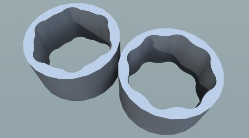

Rifling Design: (PICTURES BELOW)
First off I think the square lands of typical rifles not to be translative of potato launching. The face created by the depth of the land seems to more directly exert shear forces.
Sketched some designs up. The left section has arc lands with equally sized bits of undisturbed pipe in between. The right section is all cut (broached), with no original interior surfaces left, with a design similar to the ridge line of knuckles.
For example a ganged broach for standard rifling.

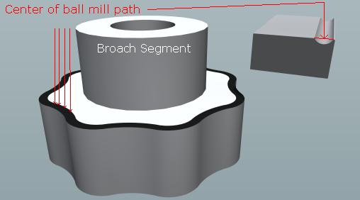

Cutter Design:
The cutter would be of a broach design, incrementally increasing the cutter size to gradually remove the material. For the testing one broach section will be drawn thru at a time to avoid re-alignment of a ganged broach. As different rates of rifling would required individual adjustment of the ganged unit. Therefore the broach would only be ganged once the desired ratio is found.
The cutter design would obviously replicate the contours in the rifling. Additionally on the face of the cutter, 1/16" inward from the edges a 1/8" ball mill would be used to produce a positive rake angle cutter along the edges.
Positive rake chipping

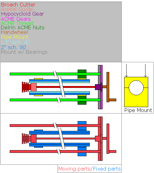

Machine Design:
Linear movement would occur on two 6' sections of angle iron using skate bearings to support a carriage. The pipe will be fixed, having a acme threaded rod driven carriage, and slowly rotating cutting head.
Similar to the article I will use acme threaded rod for tapping, however milling slots lengthwise instead. Then drilling a pilot hole the size of the root diameter.
During testing I'll use steppers, but for a final design the two movements will be geared together and operated by rotating a handwheel connected to the acme threaded rod. Using a hypocycloid reduction gear for the rotation of the cutter.

Two rifling designs
Two rifling designs

As you see I got stumped on sketchup, but the 1/8" ball mill, 1/16" inward from the edge, creates the cutting edge.

So you are going for a push die style of cutting (correct me if I'm wrong) If memory serves correct then this will be a slow process.Have you thought about the pipes OD changing from the machining process,such as "ballooning" of the pipe.
CS
Posts: 1837
Location: Southern Utah
Tue Sep 08, 2009 10:17 am
Actually pulling, slow... it'll be 10TPI so in the test range that is 90-180 seconds per rifling pass. Made a diagram to clarify the overall function of the rifling machine. So with the 2" sch. 80 sleeved around the 1.5" pipe that should help out with ballooning. More importantly the cutter should engage rather then deform and create such a deflection/ ballooning force. IE wedge. Similar to using circular saw and if not enough material is cut it will deflect the blade.
Uploaded the rifling machine diagram: riflingmachine.PNG btw it is shown just prior to the start of the rifling process.
