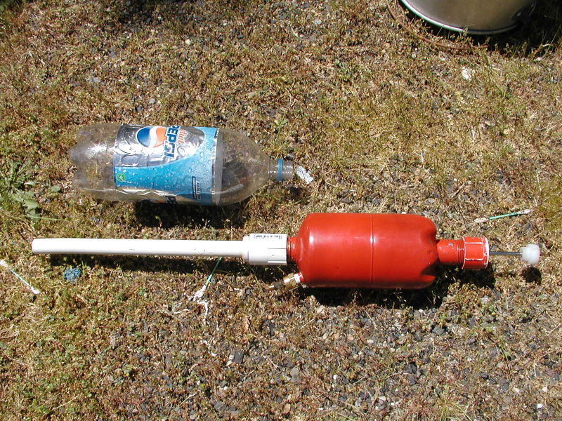

Garden hose quick connects have been used as both fill ports and launch nozzles. IIRC, the nozzle is a bit too small to be efficient but it's simple to do.
http://www.xinventions.com/main/spud/rocket.htm
A water rocket doesn't really need all that much thrust. And, a smaller nozzle gives lower thrust but for a longer time than a larger nozzle.
Personally though, I think the unmodified bottle neck works fine. Google for "Clark Cable Launcher" for a pretty simple trigger system that can be operated remotely. With remote operation you can pressurize the bottle up to 200 PSIG.

IIRC, the garden hose quick connect is 9mm (.35") ID. That gives a thrust at 100 PSIG charge of ~10 pounds (Thrust = 2PA). At lift off a 2L bottle + water probably weighs about 1300g (3 lb). Just before "burn out" the rocket's weight is only a few tens of grams and the pressure has dropped ~3x. The thrust is way down but the rocket weighs almost nothing just before burn out.5.0 mm = 0.196"
Implies a cross sectional area of .03 sq in. At 100 psi (about the "nominal" capability of a 2 L bottle) you're talking 3 pounds of thrust.
AT BEST.
