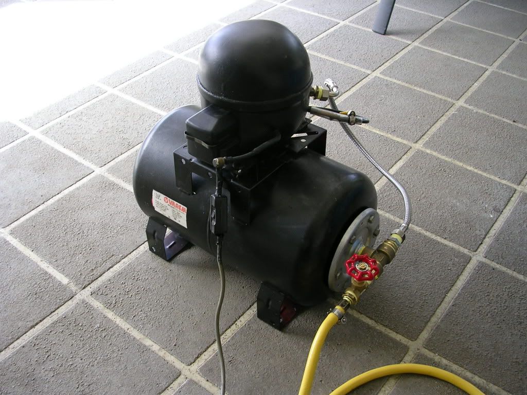

My Homemade Air Compressor (fridge compressor)
jmadden91
Posts: 246
Joined: Thu May 07, 2009 6:03 pm
Location: Queensland, Australia
Tue Oct 13, 2009 11:58 pm
I have been collecting bits for this for a while now. But its basically finished. The tanks rated to 220psi, I wont be running it that high. The fridge compressor is slow to fill, but manageable (approx 10 mins to 100psi, maybe a bit longer). I have another one in the shed I may hook up if it annoys me but for the time being its fine.
I still want to add a 3 way ball valve just after the compressor so I can both bleed the tank and hook it directly to a high pressure gun to fill.
I have an electronic pressure switch I just need to work out how to wire up, but im not sure if I will bother with it. I think I will simply add a 150psi or so pop off valve, so once it reaches the desired pressure it simply starts to vent, rather than turn off.

Very nice looks good.I was going to put my one to a 400psi tank. Do you think 2 inch steel can take 500psi ?
where did you get the electronic pressure switch? it would be nice to put it on.

Wed Oct 14, 2009 4:50 am
Probably mate but dont hold me to it. Google it. And my neighbor just brought the switch home for me, along with the tank :D
But yeh a high pressure tank would be the best, however finding a high pressure cut off switch and stuff is hard to find.

That looks sweet! Nice build.
Two questions:
Doesn't the compressor get very hot after a while?
Is that yellow hose pressure rated?

Wed Oct 14, 2009 6:24 am
jackssmirkingrevenge wrote:You can use the vented air to operate a piston that operates a toggle switch ;)
Now that sounds like an idea, do you have an example mate?
@psycix, yeh mate it has a working pressure of 300psi and a burst pressure of 1200psi, I have another 15m of it in the shed lol it was on special. And yeh it does get pretty hot, I have a few 240v fans from above a stove (they look identical to computer fans) that I am considering mounting on top of the compressor for cooling

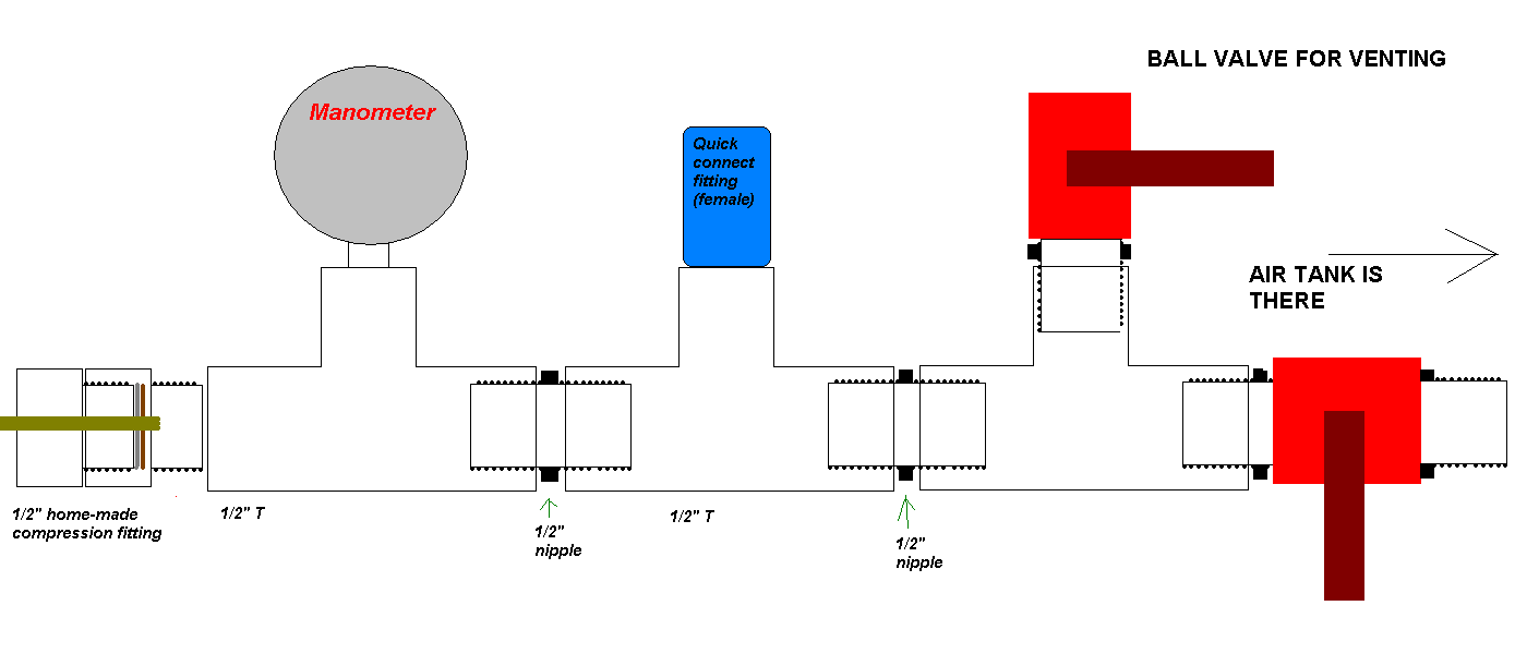

Wed Oct 14, 2009 1:56 pm
wow it looks pretty neat....
does you pressure switch have an inbuilt vent valve ??
you don't need a 3 way valve... you just have to connect everything in a different way..
pic added

Wed Oct 14, 2009 6:01 pm
Thanks mate, yeh thats the other setup I have been toying with. It will just come down to whether a 3 way valve is cheaper than 2 ball valves or not. Thanks for the comment mate
oh and Im not sure if it has a vent valve, is there anyway I can tell?
Wed Oct 14, 2009 6:25 pm
IDK really....these things probably have a small solenoid valve... but the easiest way is to wire it and connect to pressure
there are pressure switches rated to higher pressures but they are quite rare and expensive so you might a well try to mod this to switch on/off at higher pressures
yeah I suppose they are cheaper and easeir to get
