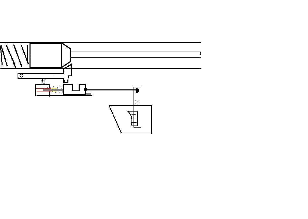

Here is a hammer that i will be using for my own pcp
but im not sure it suits your needs as it is for use with an inline barrel(for an airforce condor)
Even, is this design ok or it wont work for some reason?
trigger system.JPG (35.74 KiB) Viewed 8499 times
