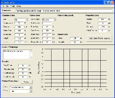

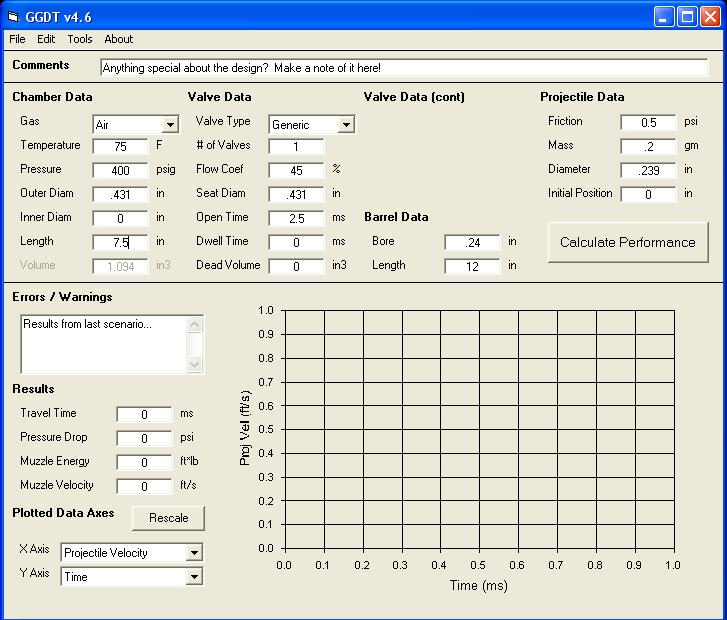

Here is a screen shot of my input. There might be something wrong but I don't know what it could be. Maybe someone could try running the data for me to see what they come up with.

dwell time can't be 0

ohh now I am lost...it did work for me with a couple of designs but you're right it does crash... if you get rid of all zeros from data it doesn't crash always but some time it does
so far I couldn't get it to crash with 'chamber/barrel seal.' types of valves I've tried about 20 different designs... try to model your design using one of those valves
it might be that the 'generic valve' causes it to crash... I recall D_hall saying that's this function is not the best implemented... I wonder what he will tell about this
ohh btw... dwell time is, IIRC, the amount of time that the valve stays open

I tried to get rid of all zeros but they are not the problem... it seems that 'generic valve' is the problem here
