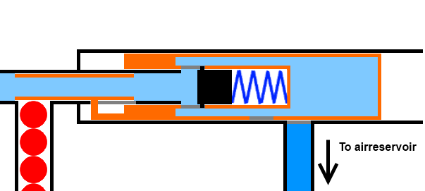

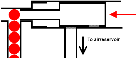

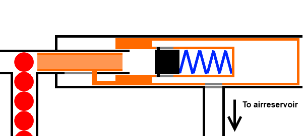

This is just a pneumatic, but loading, firing and refilling is done in one stroke.
Charged:
Firing:
EDIT: I forgot to draw a spring in front of the bolt:

I can't see how this counts as a QDV. The valve is only moved manually, and doesn't have a pneumatic "kick" to open the valve.
It also looks like it'd be a pig to get all of those seals to work.

Ragnarok wrote:I can't see how this counts as a QDV.
This is the piston of the QDV
Here you can see the air pushing the piston back when is fires.Image

I'm almost dead sure this isn't a QDV.
I concur with Ragnarok, it'd be a real PITA to get those seals to line up. I think you'd have to relate (and with great precision) the spring constant for the two different springs to the location of the holes.
Not only that, but the opening speed of this valve would be incredibly slow. If you don't push the big cylinder forward hard enough it'd probably just fart, because as soon as the valve opens the pressure introduced into the barrel forces the firing mechanism back and tries to shut the seals. By comparison, as soon as a QDV is triggered, the airflow forces the valve open faster, not slower.
And also a side note, if I take your diagram literally, there's a very good chance that it would simply dump the magazine out the barrel if you bumped it even the slightest. There's nothing keeping the top BB from slipping down the barrel.
Aside from all of that I do LOVE the concept. This has inspired me to work on a design I've left lying around for far too long.
I'd actually just take all the springs off and operate the center cylinder manually through a sealed rod out the back of the rest of the valve. That'd let pneumatic forces take over, instead of being constantly restrained by the springs.

ByeBye wrote:This is the piston of the QDV
Ah... the positioning of the arrow implied something different (air flowing through, rather than that being a plug/cap), but seeing that - yeah, I guess that counts.
My comments on the seals still stand though, and as Jack said, still rather complex for what it's actually trying to do.
What's your plan for stopping it kicking back violently on firing?
If the chamber and valve have been pushed forwards, the recoil kick is going to be directed into just them... and whatever pushed them forwards.
That said, pulling them forward with a spring (so the user's hand is not directly implicated) would help that. Heck, get the combination right with that and you could go full auto.
