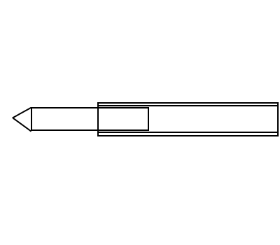

- POLAND_SPUD
- Posts: 5402
Yeah that's what I was thinking about... though who said you can't build one yourself ?
anyway you might as well use drag stabilised ammo... get, let say a
10cm X diam. 20mm steel rod and sleeve it into 30cm lenght of PVC pipe

I wouldn't know where to buy steel rod and I can't weld and don't know anyone who can. There's a mag repair shop not far from me that I've held weld some stuff for me. Usually you can give them a 12pk of beer or $20 and they'll weld the odd job for you.
You think it's better to go with a drag stabilised projectile over a fin stabilised projectile? I guess that would be much easier and cheaper to construct, as long as it keeps the drag coefficient down it should be fine. How difficult is it to construct very low drag projectiles and what would a good drag coefficient be for shooting long distances?
- POLAND_SPUD
- Posts: 5402
Hmm I think that something along these lines should be enough... sure it isn't optimal as far as cd value is concerned, but as long as it stays stable in flight and has high mass then it should be ok
- lol I is an artist ;-)
- mcrowley_lol.png (2.67 KiB) Viewed 10580 times
