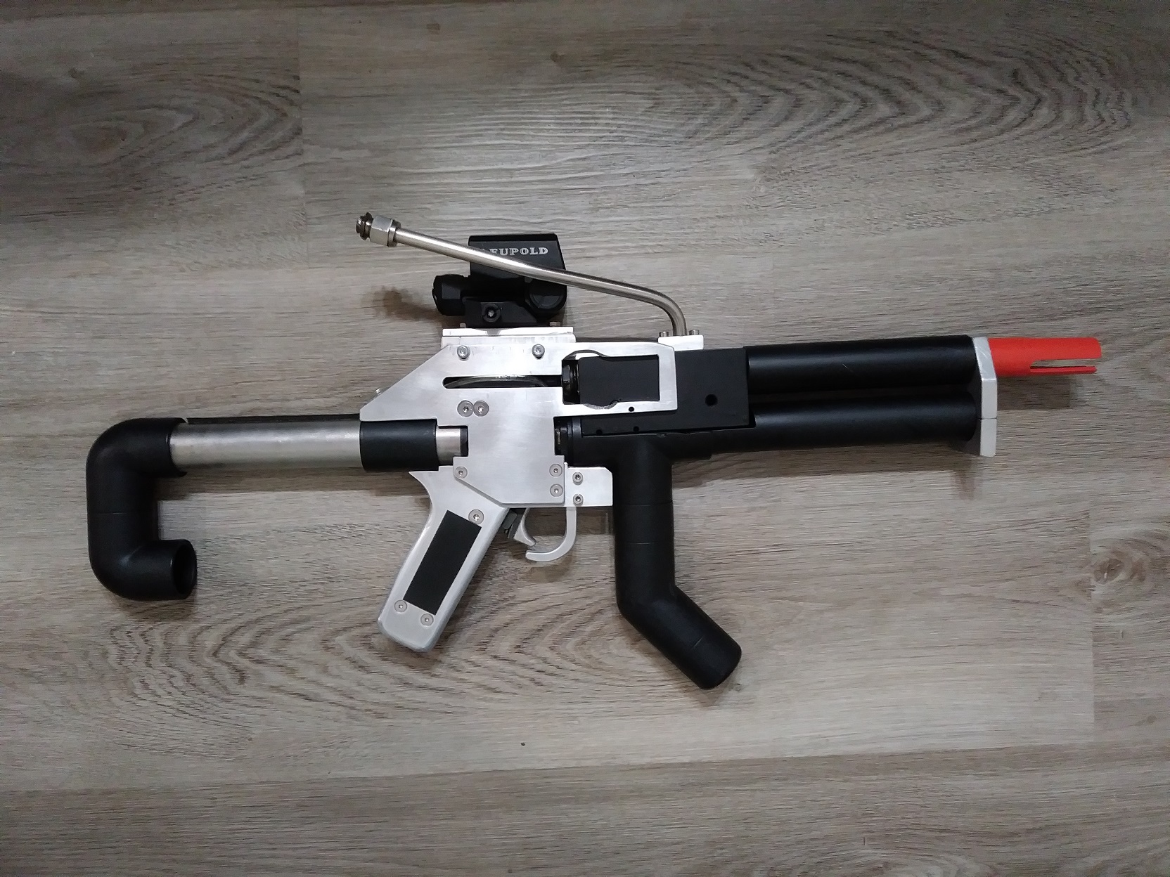

This turned into a semiauto by making a simple spring loaded piston, I'll find some pictures. If I was going to build another semiauto I would do this again.
viewtopic.php?f=29&t=26658
This is how the piston works, the block is aluminum.
I made it from a piece of nylon and a bolt

You may get away with no bolt at all. I have done that multiple times. Just seal the magazine with the barrel so that no air can escape. This makes the whole thing more powerful and simpler
