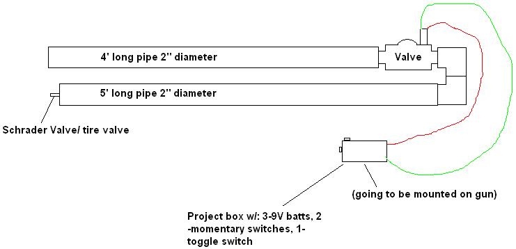

Ok I have built a very very basic Spud gun a couple years ago and now I am interested again. When I first built mine their was no such thing as using a sprinkler valve (or at least that I heard of). Everyone who made newmatic guns used ball valves. So what I understand about sprinkler valves ar that they are a ball valve just automatic right? Ok going off of what I think I have a design and just wanted to see if I am right and if it will work. I will be using a schrader/tire valve to put air in my chamber. Then this will be blocked with a sprinkler valve then into a barrel. I will not be using a blowgun (if it isn't needed) i will be constructing a box with some switches to fire it. So please let me know if this will work? Here is a little design i made quickly.

no sprinkler valves are diaphram valves
the diaphram is a peice of rubber that rests on a seat with air all around it exept under the seat and to set it off you let a small amount of air away from above the diaphram which sucks it away from the seat letting air in the barrell

also make either the barrell smaller or the chamber bigger for a stronger gun

yeah, a good barrel size for a 2" chamber i think is about 3/4" to 1/2". tray thoughs they work great. everything else seems fine though
i've used 1.5" barrels with 2" chambers well, as long as you have a good ratio there shouldnt be a problem. as for the sprinkler, if you want to, you can mod the valve, that way you dont need to keep replacing batteries, and it will also make it faster, and give you more power. there is a how-to on modding a sprinkler valve in the how-to section of this site.
also you should tap your hole for your schrader vavle where there is 2 layers of plastic, where a fitting is glued over the pipe.
make sure you only use fittings with the marking NSF-PW DO NOT use NSF-DWV marked fittings, they're not made for pressure and are unsafe. also make sure you only use pipe with a pressure rating such as XXX-psi DO NOT use cellular core pipe.

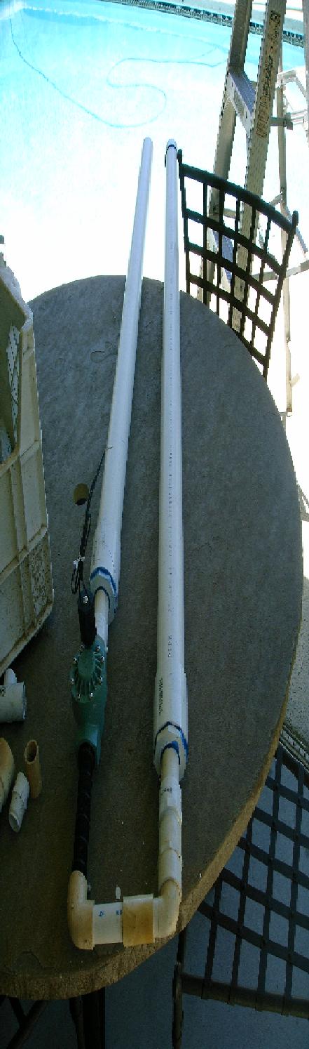

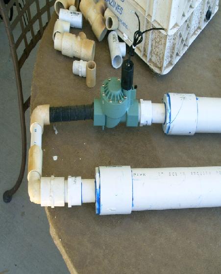

ok here is a pic of my gun i am building. Everything is there except the electronics for the solenoid. It will be an interchangeble barrel. ok so see if it will work like this. one thing i still need to do is put the schrader valve on sumwhere. sorry for the bad quality and small photos. It wouldn't let me upload the original because they were to big.

waht the hell kind of fittings are they? they look yellow, they cant be pressure rated, and i can tell it looks like the coupling and reducers are DWV by the socket depth, what is the black fitting beween the elbow and the valve?

i think the black thing is jsut pvc wrpaed in black grip tape cuz i think thats his handle

ok those yellow pipes were just really old pipes my dad had in a box. I went to my grandpa's and he had brand new pipes. Everything is much better now i cant take a pic currently but I will soon. Ok "you should try modding the solenoid valve so you dont need batteries, and it'll give better performance" i dont understand how modding it will make it possibly to use no batteries. I think I get it would you always have your compressor hooked up to the blow gun? I dont realy get it. If what I said is true the reason I dont want to mod it because i dont want it always hooked up to the compressor. Please Explain.
