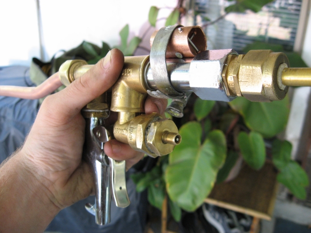

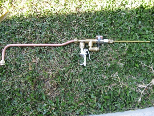

Mitcho's BB Pistol Mark II
that is pretty cool. maybe you should shorten the chamber and make the barrel longer, other than that i would say its pretty much perfect.
if you had to guess, what kind of volocity do you think you get from it?
The chamber is pretty small mate. Takes me 10 sec to get to 150psi with my shock pump. If I had to guess off the top of my head, Id say 500-600fps at 150psi. Not too bad for the size of the barrel but yeah....a 60cm barrel would be ideal.

Very nce. I really like the ghetto scope/ sights.

Looks like a fold out stock on an Uzi,repeating shotgun or similar,seems like it would should well in the position were that stock goes.Maybe loose the sites.They just don't do it for me but apart from that!She looks great! :thumbleft:

Very cool indeed, can i suggest that you JB the scope on and get rid of the un-sightly hose clamp? And how did you bend the copper (looks like a rush job, no offence) A tip is to fill the tube you are bending with sand

looking good, though if i were you I'd remove the stock and make it a bullpup, P90 style - you´d get the same overall length but with a longer barrel, less noise and more power

i suppose since you can bend the barrel into any shape or use angle bits you could make the gun look even more awsome then it is right now
Haha the stock was a rush job. I had no pipe bender for the rest of it. I found the pipe with the 90' bend at the end. I just stuck it in the comp fitting and just bent it by hand. It was just a peice of scrap that I found in the bottom of the shed.

i agree, and the p90 is an awesome gun.jackssmirkingrevenge wrote:looking good, though if i were you I'd remove the stock and make it a bullpup, P90 style - you´d get the same overall length but with a longer barrel, less noise and more power
the stock makes it look cooler.

That's what i imagined.

There is no bend to the barrelbattlemonkey wrote:i suppose since you can bend the barrel into any shape or use angle bits you could make the gun look even more awsome then it is right now
