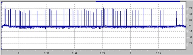

Here is how I did mine, just a pair of phototransistors mounted on a piece of sliced up PVC. It clips onto the barrel of the gun being measured. The light source is just ambient light.
For Alihisgreat; all you need is a pair of light sensors seperated by a known distance. You record the changing light level caused by the projectile's shadow as it passes over the detectors by plugging the sensors into the MIC input of a PC or laptop. You use audio recording software to record and analyze the peaks.
For other folks, yep, my web site is down. It is being moved to a new server.
Edit: The images are in the wrong order, second image should be first, third image should be second, first image should be last.
Zooming in shows the pair of peaks for each BB.
Recording of a BBMG firing. Each peak is actually two peaks. The chrono gives both the ROF and muzzle velocity.
