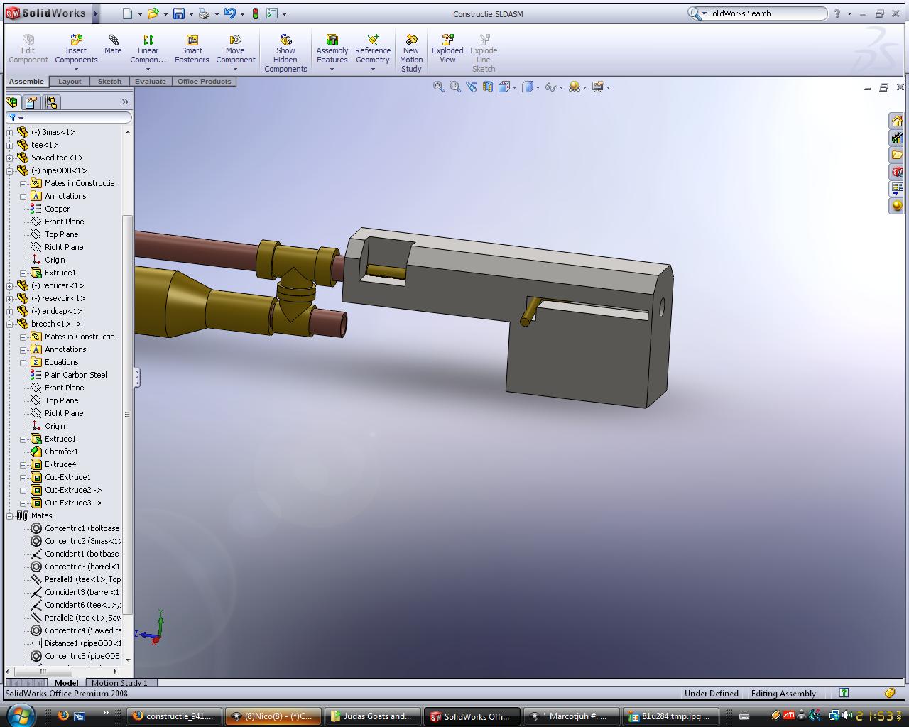

Making some more progress...
Merged:
That stacked valve looks sweet.
To the drawing board! (wich is the pc so i don't really have to move..)
*edit*
Cool it would seem that Ant is a fellow Dutchman. :D

Mon Jan 07, 2008 3:41 pm
off topic- what is this program you are using exactly???
Necrosis
Posts: 239
Joined: Tue Jul 03, 2007 10:03 am

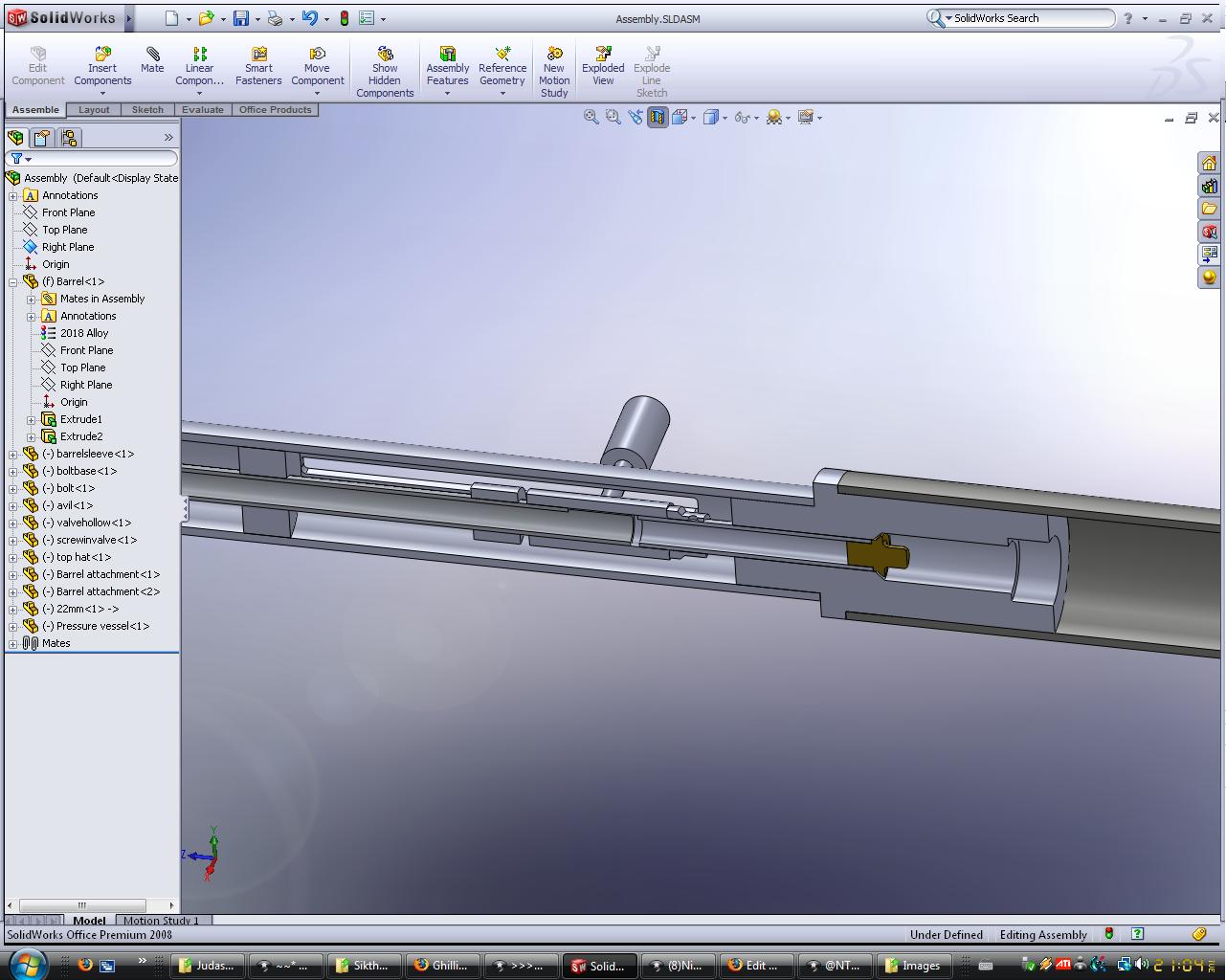

Mon Jan 07, 2008 3:56 pm
Making more and more progress.. :D
Solidworks is the program.
Antonio
Posts: 508
Tue Jan 08, 2008 3:49 am
Mr. Beaver wrote:off topic- what is this program you are using exactly???
LoooL, if you open the picture it says solidworks at the topleft. You cant miss that. Btw Necrosis Nice gun design, looks great.
You don't have to be a jerk ant i asked what is the program not how it's called i ment is it like those 3D cause it's it's look like from a fu*king cartoon tv show...... :wink:

Tue Jan 08, 2008 1:16 pm
Mr. Beaver wrote:
Making a photorealistic render takes a few dozens of hours of computing alone :wink:

that solidworks thing looks pretty cool, it must take a while to put in all the fittings and stuff though.. and btw your design looks pretty cool :)

Yeah, I have access to a lathe though, so I will actually make a condor style valve now, inline in stead of under.
ooh a hammer valve good luck with it i'm looking foreward to seeing the finished product already :D
