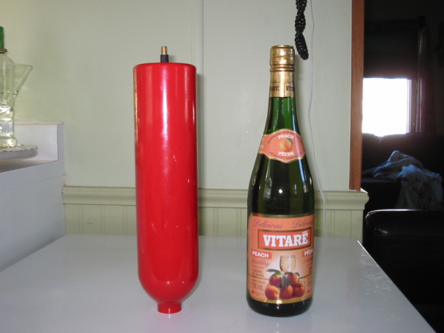

How small (in diameter) do you think the bb reservoir should be for most efficiency? The first picture is the exstingusher compared to a vitare non-alchoholic wine bottle no I'm not advertising andthe second is the tank in my hand.
P.S. I think that you would be able to screw in a 3/4 inch male adapter into the threads if you are wondering and which would be better for putting air into the bb reservoir a blowgun or a mini ballvalve?
